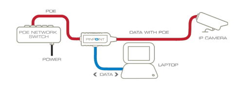

ssmith10pn 0 Posted June 14, 2014 http://www.veracityglobal.com/products/ip-camera-installation-tools/pinpoint.aspx Share this post Link to post Share on other sites
