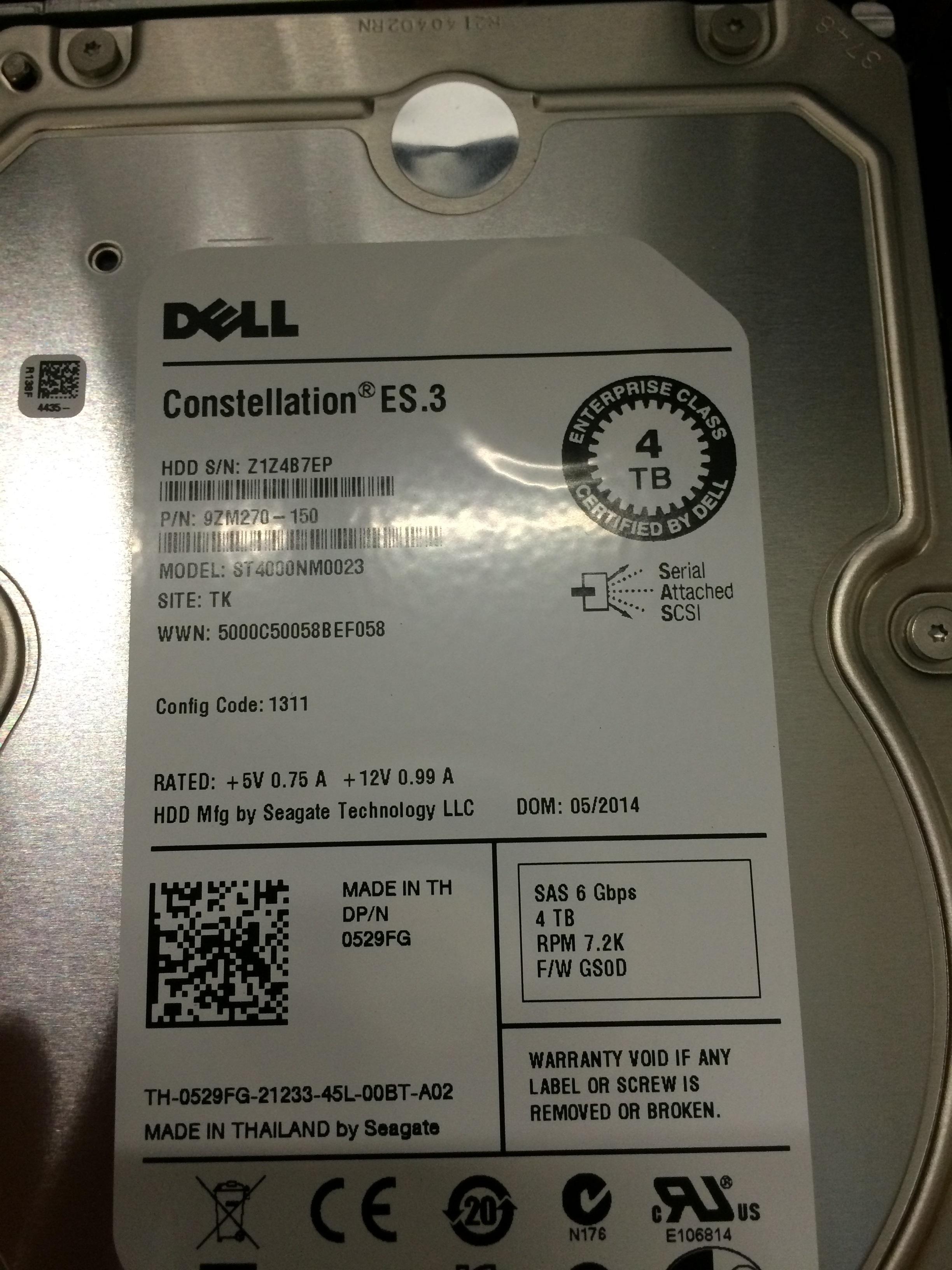

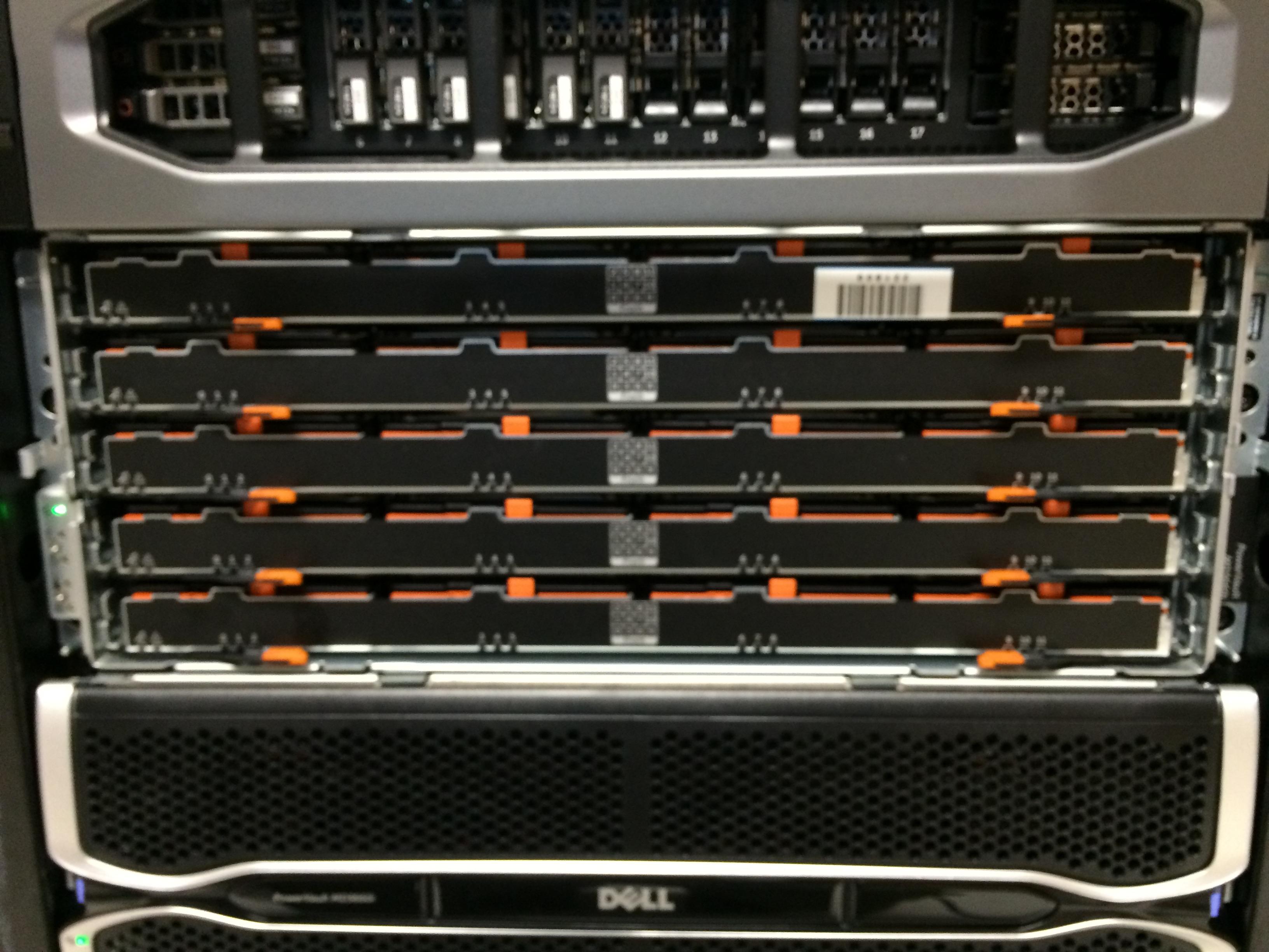

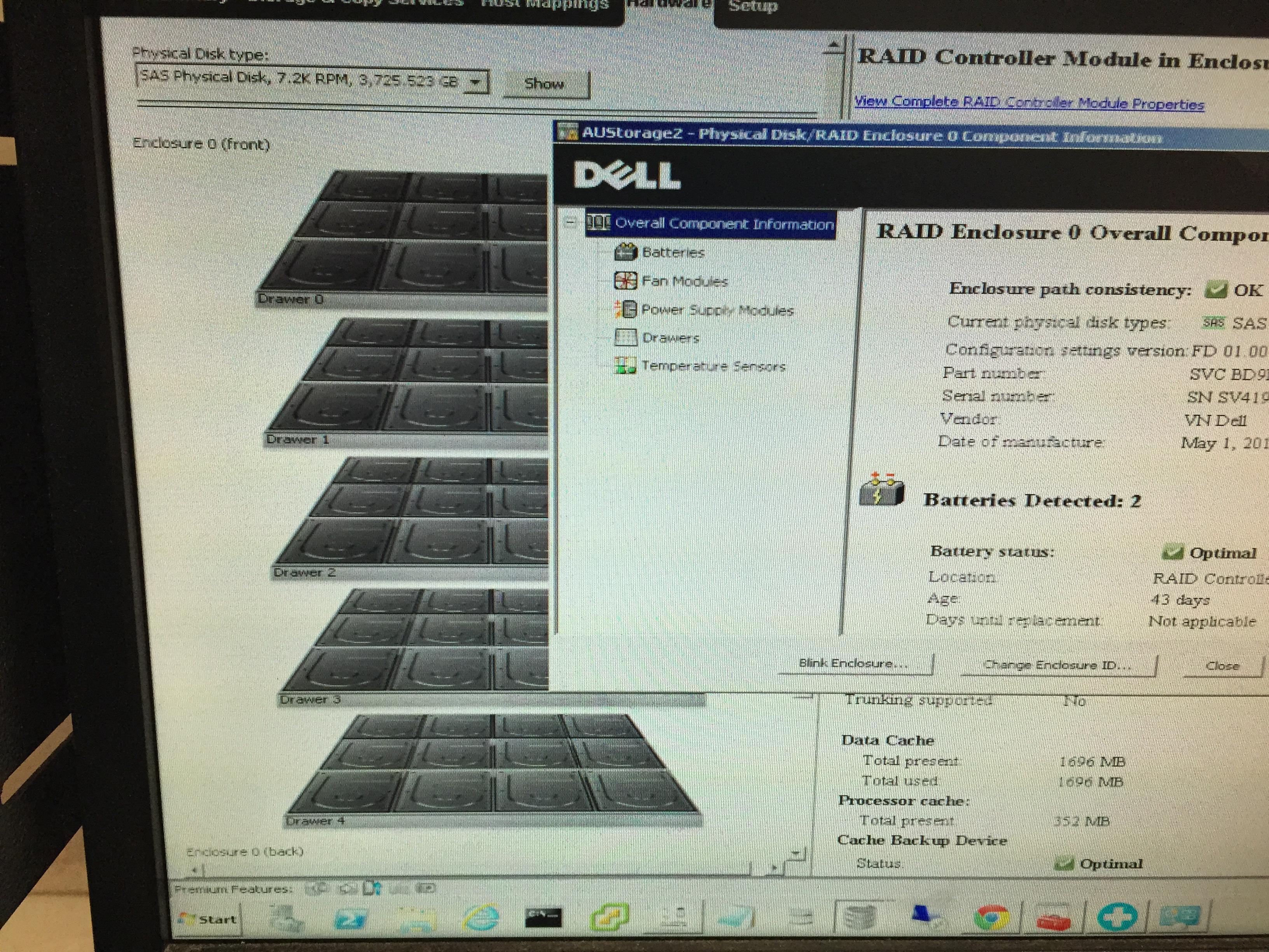

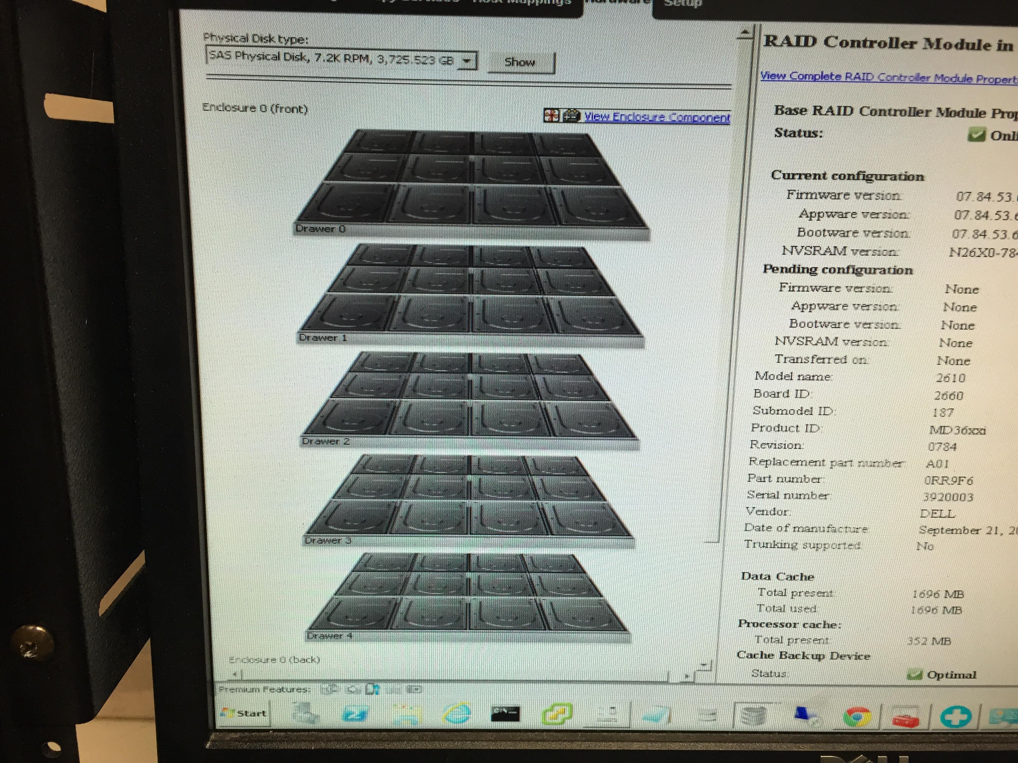

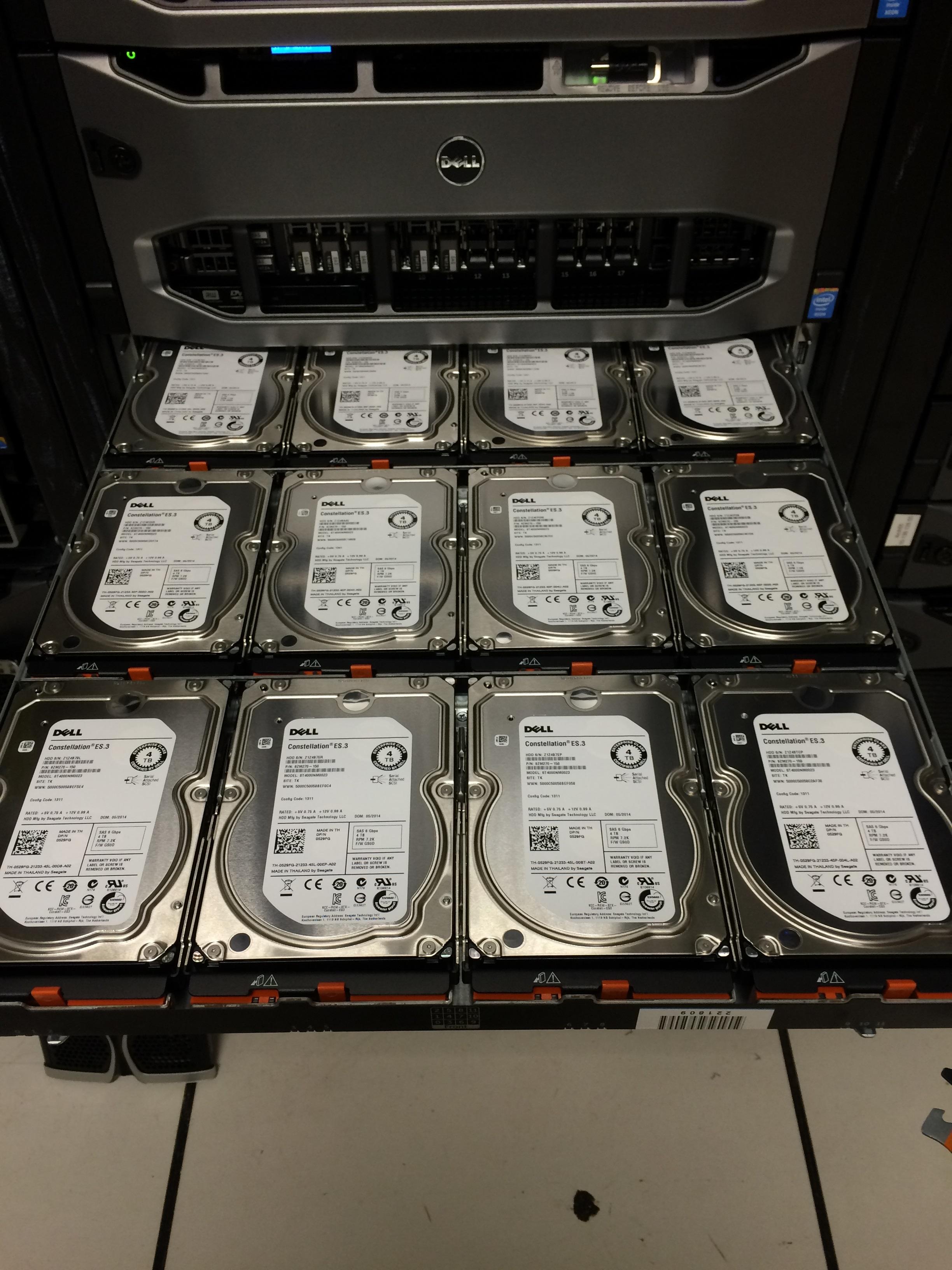

Yepvegas 0 Posted January 26, 2015 I know this is an old post what drives did you end up selecting. I have 9 of the Dell R72XD's currently in place. 24 900GB 2.5in SAS drives two SSD's for the OS. The 24 drives is configured in a Raid 10. On my test machine I have 120 1080P camera running at 15IPS and I am not even stressing the unit yet. For larger systems and the price point it is difficult to find a better value. Share this post Link to post Share on other sites
buellwinkle 0 Posted January 27, 2015 I have not found that using slow HDD has any effect on the recordings. Heck, I'm running a slow 5400RPM 2TB 2.5" drive with a dozen cameras and no problems and that includes the operating system. Share this post Link to post Share on other sites
Yepvegas 0 Posted March 2, 2015 Nice set up we looked at a similar option for sever/ storage solution but for our needs it was not quite what we needed. Currently we are using the 9.8TB of formatted storage on on the server for live video only, and archive to an EMC Isilon unit. Currently we have about a half a PB of video storage. I will need to add a tray possible two if we keep adding on at our current rate. Share this post Link to post Share on other sites
