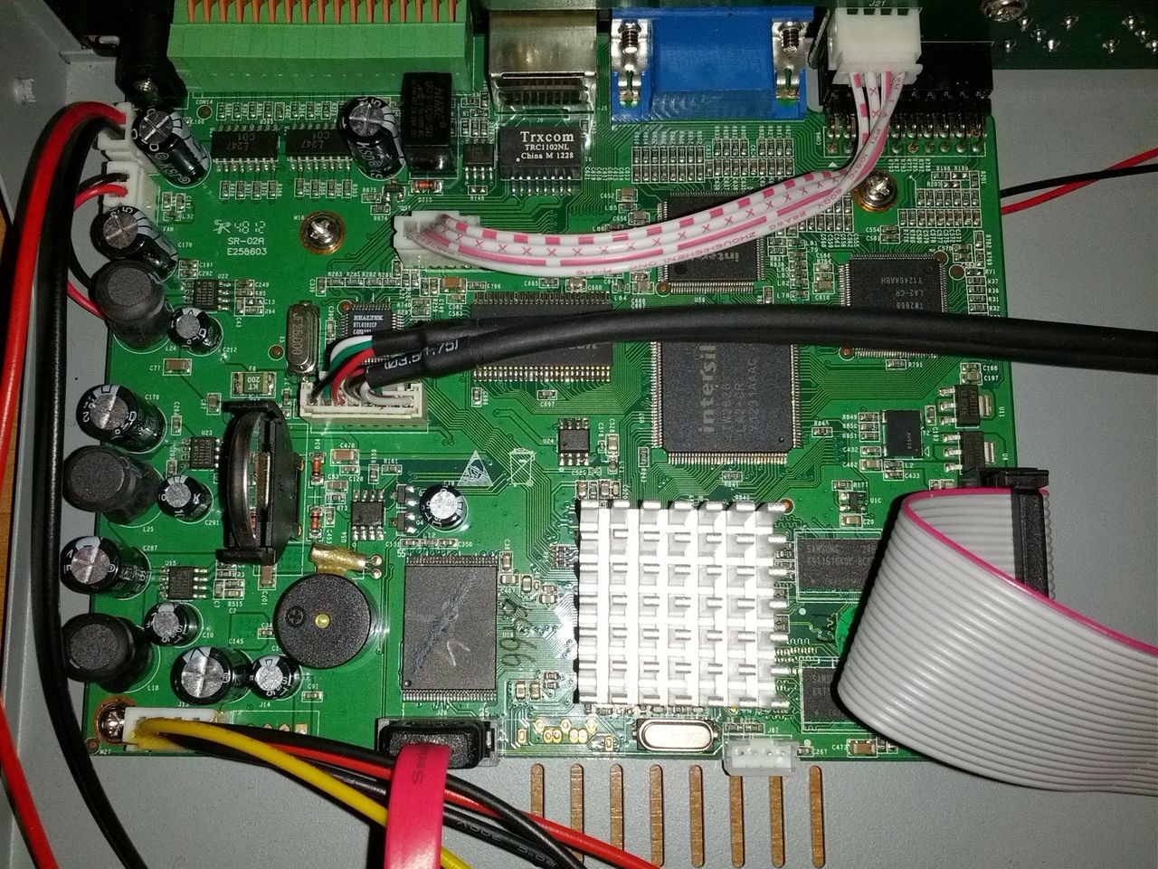

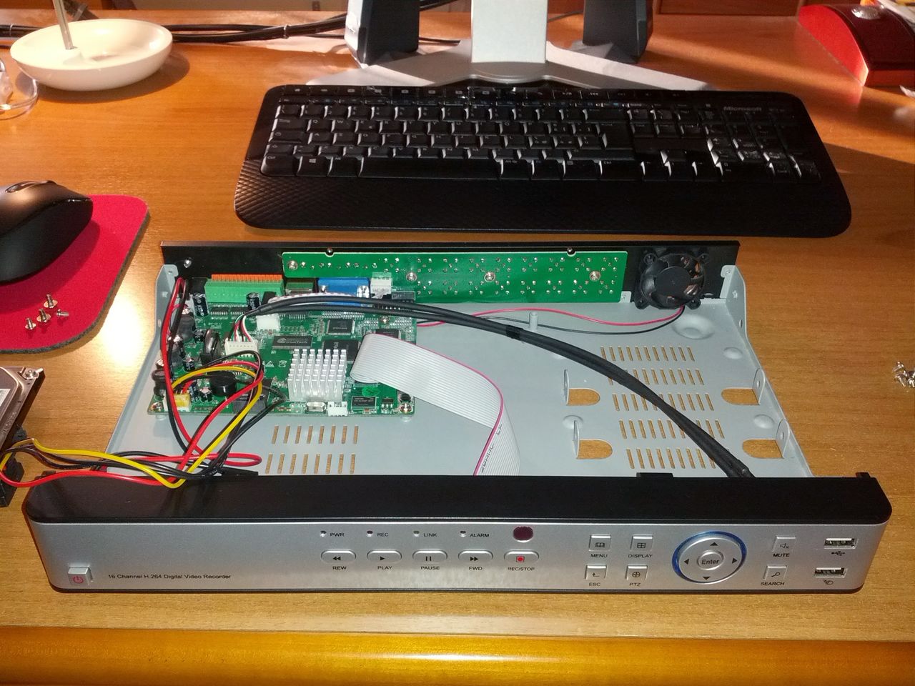

Hello, sorry for my bad English.
I Have a 16ChDVR. I don't know REAL MANUFACTURER !
I had telnet access without any problems, and I corrupt the bootloader or the existing software ( kt_dvr process ) when trying to install my own version of the software, developed by me.
Now dvr stuck on Welcom screen. I noticed that the network card is active (even if no ip assigned) and the usb reads "something" if i insert an usb pen ....
The problem is that I do not have much experience with these embedded systems and their mechanism of boot. The system software was very similar to this:
