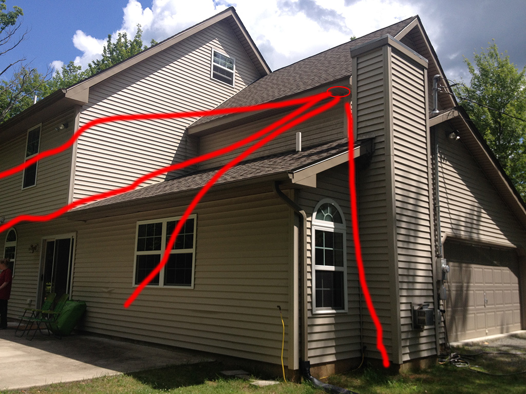

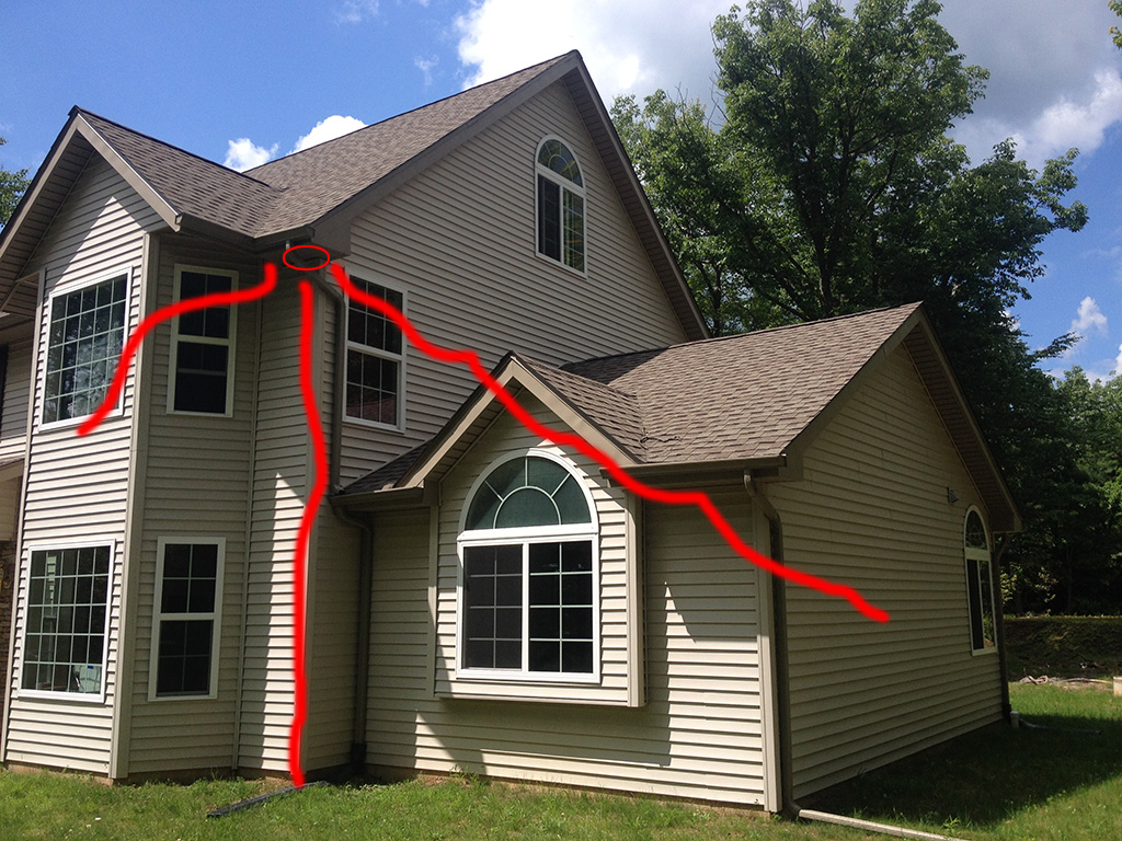

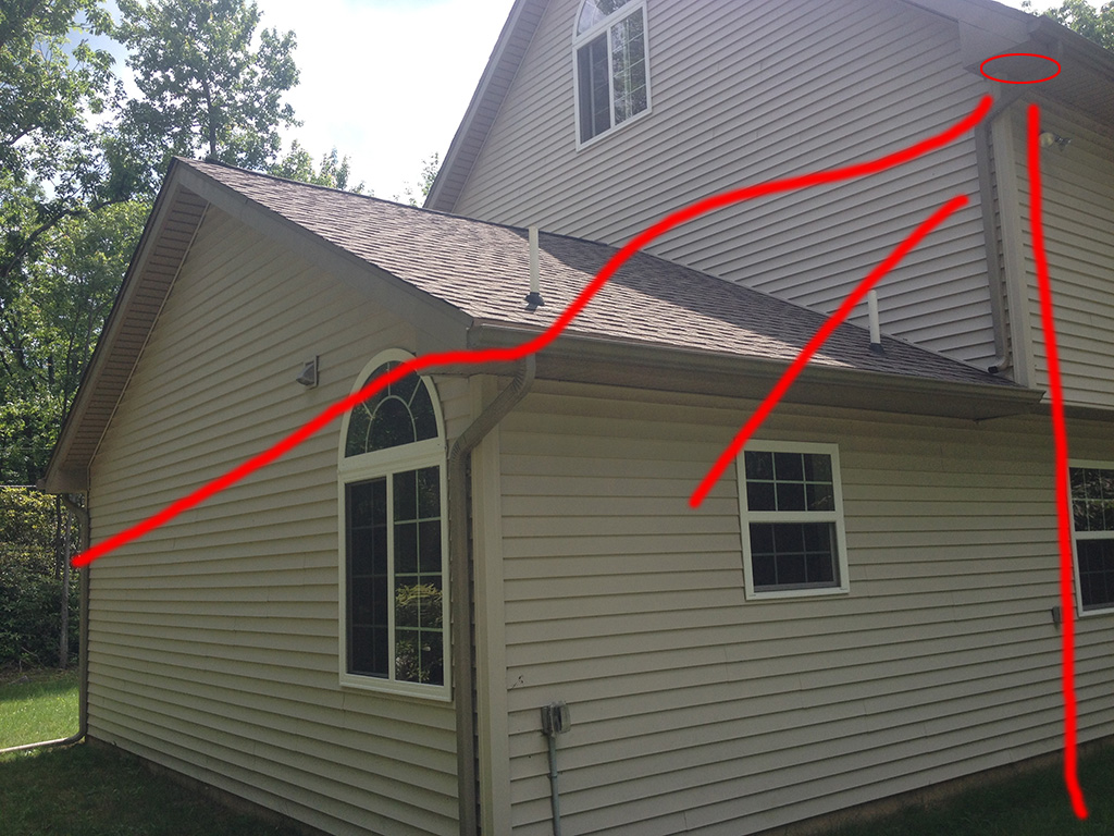

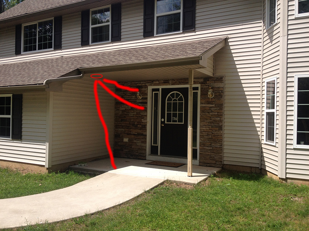

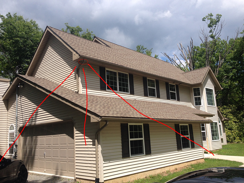

Ok, those are the high-level points that I can think of. I've also taken a few shots of our home and mocked up where I'm thinking of mounting either bullet or dome (preferred) style cameras. Again being new to this, please call me out if the positioning and intended coverage direction is crap or unrealistic.
Front Door
Front Left
Front Right
Back left (I know I'd be missing this side of the house, if it's just not possible to cover the perimeter of the home with 4, I might pick up a 5th camera)
Back Right
