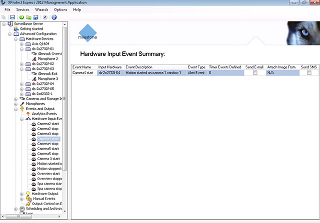

1. Under Advanced Configuration on the left, then Events & Output, right click on Hardware Input Event and select Add New Input Event. Select the camera you want to do this for and check Motion Started on Camera 1 Window 1 and give this event a more unique name, like Driveway Motion Start and click OK. Then do the same for Motion Stopped on Camera 1 Window 1, you'll need both. You can also pick other stuff like Face Detection, Audio, whatever your camera supports

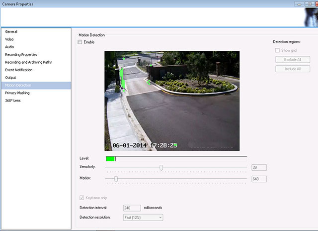

2. Then go to Cameras, select the camera, click the OPEN button and click on Motion Detect and uncheck Enable. It will give you some warning.

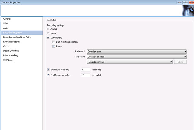

3. Now select Recording Properties on the left, uncheck built-in motion detection and check Event, select the Start event you created, select the Stop event you created and click OK. While here you can enable pre and post recording, I usually make it 3 and 8 seconds respectively
