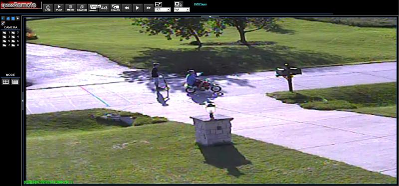

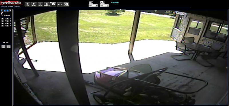

Not sure of the model but here is a photo of them
Here is a couple screen shots from the video

Well that's not too bad, it is pretty obvious the kid on the scooter is Justin Beiber (looks like he is carrying a dozen eggs in his basket)
