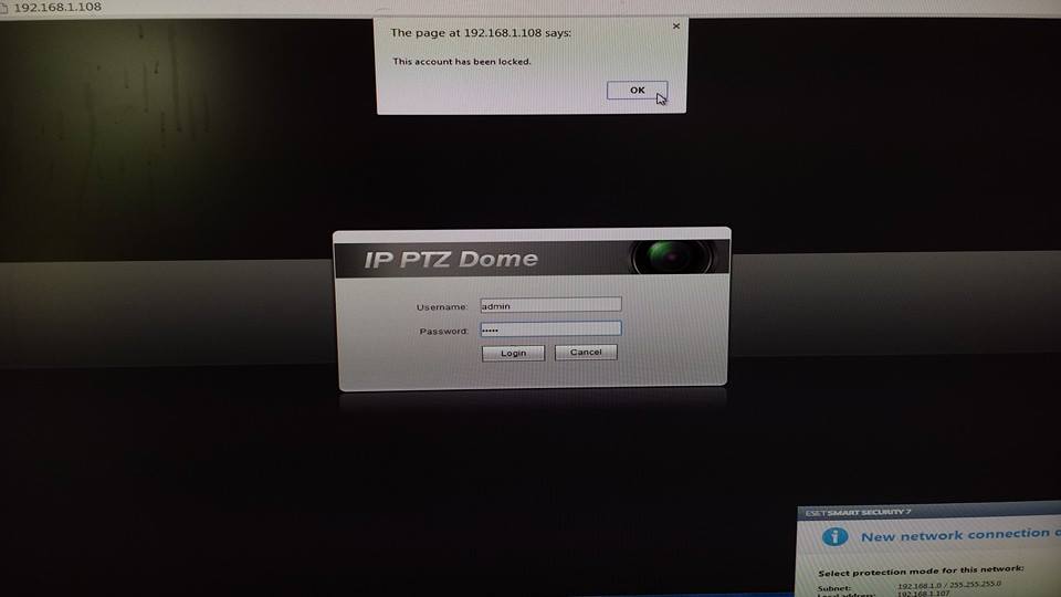

I just received a SD42C212S-HN but it came with a defective CD-ROM disk (bubbled label), I've been tooling around on Dahua's site downloading everything that looks promising,,,,,but not having much luck so far.
All I know so far is its default ip address is 192.168.1.108 (I haven't changed the ip address on any of my machines yet so I can plug into it that way

admin/admin
Admin account seems to be locked - you've tried more than 3 bad combinations in a 30 minutes timeframe. Reboot the camera and retry admin/admin.
I got it - thanks dexterash.
