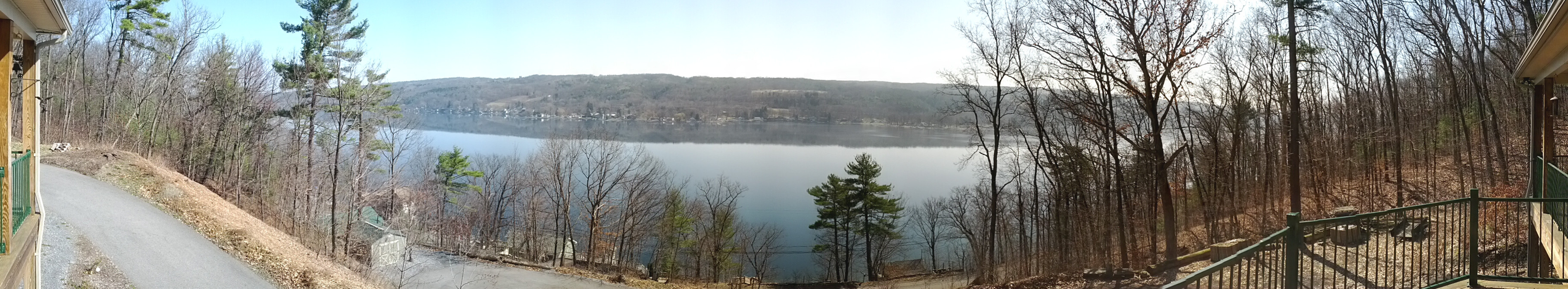

Here is a spring time photo of the view he would be looking at

Thanks for the advice. I hadn't thought of the mist/haze distorting the image, but I think I prefer the 30x due to the distance we are from the lake. I would say we are about 350ft diagonally downward to the edge of the water. Then the lake is about 2500ft wide, so I think the 30x would be better.

The Dahua PTZ has 4 LED's that adjust to the PTZ amount from wide angle to full telephoto. Even then, don't think it will add much value on the lake. Most PTZ can only go to the horizon, so mounting it too low, you will not be able to see things higher when you zoom in, maybe the shoreline, but not much above it if there's taller objects. That's why I like the sd59212s or sd59230s because they are the only ones on the market that I found that can tilt up 15 degrees.
That's a major selling point for me as well. We will be mounting this about 200ft up in the air over the lake which is about the level of the house deck. Even at +200ft above the lake, we would still like to look up higher.
