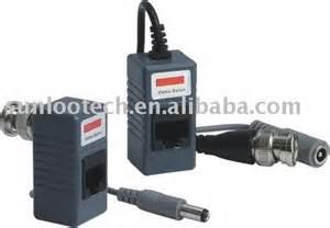

You can also run both power and signal on a single cat5 if you want to
