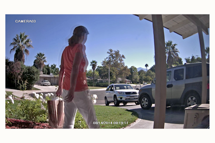

Bolster 0 Posted August 20, 2014 Can you folks tell me why I'm getting triple images with my Q-See QH8003B (SDI) cameras, running on the Q-See QT714 system? They seem to appear only for nearby fast-moving objects. Thanks! Share this post Link to post Share on other sites
Bolster 0 Posted August 22, 2014 Q-see is recommending reformat the hard drive (which did nothing) and now update the system. But isn't it possible this is a camera issue? I asked Q-see if these were Dahua cameras and they said no. Share this post Link to post Share on other sites
buellwinkle 0 Posted August 24, 2014 Q-See like most of the larger OEM's is not loyal to one manufacturer and that camera is definitely not Dahua. That is a weird effect, but since the camera is analog, the issue is probably with the DVR. Are you seeing this only on one camera or all the cameras? Share this post Link to post Share on other sites
mgb 0 Posted August 24, 2014 Could the problem possibly be coming from digital noice reduction (dnr) or wdr being set high? Also I understand that hdsdi is very picky on csble quality, just wondering if all cabke on this intall is equal and if problem is on all the cameras or just one. Share this post Link to post Share on other sites
