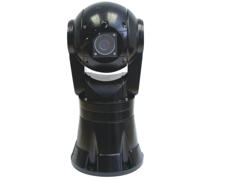

ilk 0 Posted August 23, 2014 I would suggest that you need to look at a different type of camera Perhaps something like this from http://www.szitsecure.com/52/i-511.html - this is not a recommendation of this particular model as I have no knowledge about this company. This is similar to the MIC style cameras from Bosch Hope this helps Ilkie Share this post Link to post Share on other sites
