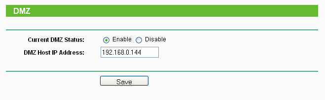

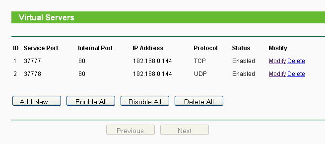

Delete everything on the "virtual server" section; that is wrong, and you don't need to set it up if you are using DMZ.

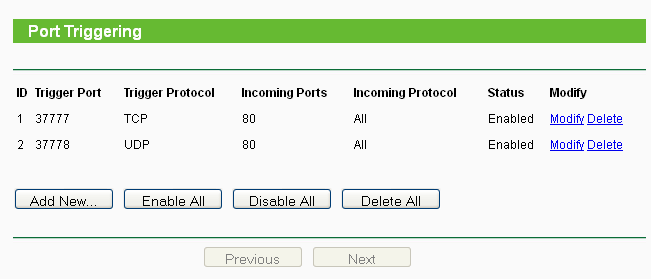

Delete everything on the "port triggering" section. That is also wrong.
You can (and I would) disable UPnP. If you put the DVR IP on the DMZ, there is no need for UPnP. I would disable it on the router and DVR.

"Virtual servers" section is wrong; he is forwarding external ports 37777 and 37778 to internal port 80.
Port triggering is not needed at all for accessing a LAn device from WAN.
