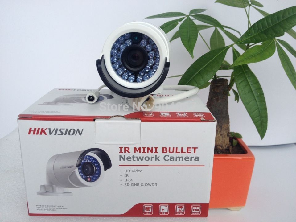

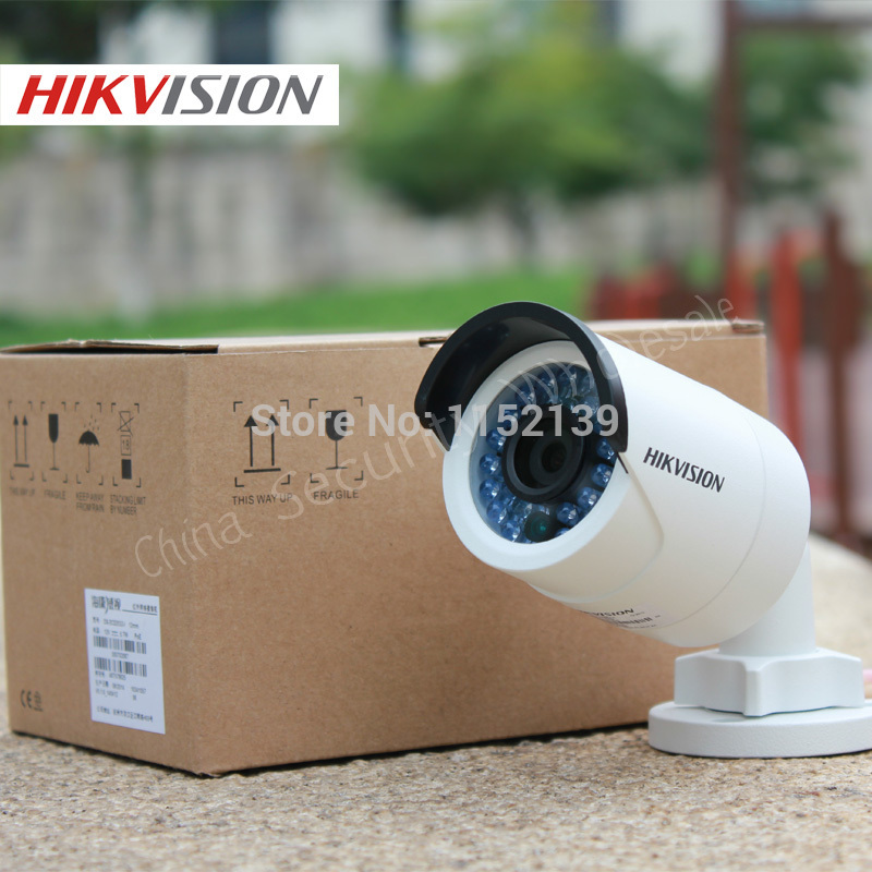

Brenning 0 Posted September 3, 2014 IIRC the Chinese cameras come in plain brown boxes, UK specific ones in Hikvision branded boxes with images of the product on etc, Chinese: UK: Ironically both of those images are from aliexpress so things may have changed since I purchased from there. My UK supplied camera came in the branded box and has had no issues with firmware updates. Share this post Link to post Share on other sites
MaxIcon 0 Posted September 4, 2014 My US supplied, CCWR serialed Hiks came in plain brown boxes. The retail style box may be something a vendor can pay extra for if they want. Share this post Link to post Share on other sites
Securame 0 Posted September 5, 2014 My US supplied, CCWR serialed Hiks came in plain brown boxes. The retail style box may be something a vendor can pay extra for if they want. Agree. I also get in Europe models with brown or color box, and they are all with CCWR serial. A brown box does not imply it is a chinese market camera, a retail box does not imply it is not. Share this post Link to post Share on other sites
