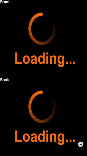

latropa 0 Posted September 9, 2014 My model number doesn't show in the IP Cam Viewer Android app but I've always (well, mostly) been able to get it to work by using the listed DS-2CD8153F-E for the main stream and DS-2CD2432-I would work for the low-resolution sub stream. All that stopped working after I upgraded my 2032 cameras to the 5.2.0 firmware. It now takes about 40 seconds of sitting on the "loading..." windows before the pictures will pop up. The cameras would load almost instantly before. This happened for both the main stream and the sub stream but I was able to get the sub stream to load quickly again by changing the setting in IP Came Viewer from DS-2CD2432-I to "Hikvision IP Camera (active-x)". Still no luck with the high-res main stream though and I've tried all the different hikvision model numbers in the app. Any idea how to fix this and what the hikvision firmware update might have done to cause it? Thanks. Share this post Link to post Share on other sites

latropa 0 Posted September 9, 2014 The official Hikvision Android App still works just fine. I guess I need to wait to see if the author of IP Cam Viewer updates it to support the new firmware for these cameras. I do have USA region Hikvision cameras though. Share this post Link to post Share on other sites
