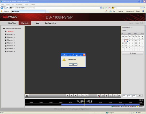

iTuneDVR 2 Posted September 11, 2014 The problem with the playback and on my DS-7108SN / P firmware V3.0.7_140805 Playback failed! In general, I liked the update. I added the Russian language in the firmware of my Chinese NVR http://vk.com/album221982133_202282913 Share this post Link to post Share on other sites
