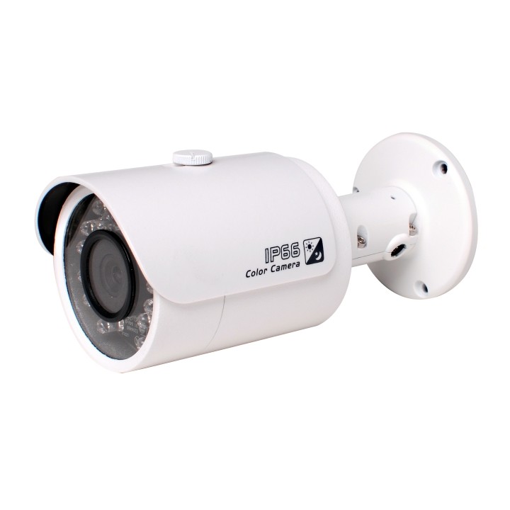

For just under £200 use 2mp camera home plug at each end of power going to gate and then use a cheap android tablet £40
