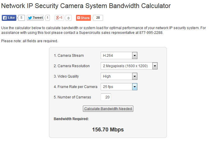

BrownChiLD 0 Posted October 30, 2014 Hi guys How many 2MP cameras can you push thru 1 Gigabit Cable? = realistically? I basically have 20 Cameras spread around a wide area.... I'm connecting them all to a 24Port Gigabit switch .. (center/neutral position).. then a single gigabit line from the switch that runs all the way to the NVR (50 meters away) .. Soo.. 1Gigabit = 1000 Mbps Twenty 2-Megapixel Cameras at high settings running on 25fps is basically just 156.70 Mbps, as per http://www.supercircuits.com/resources/tools/network-ip-security-camera-system-bandwidth-calculator So is this still alright/relaxed? Can I add more? any advises? Regards TJ Share this post Link to post Share on other sites
ak357 0 Posted October 30, 2014 Hi guys How many 2MP cameras can you push thru 1 Gigabit Cable? = realistically? I basically have 20 Cameras spread around a wide area.... I'm connecting them all to a 24Port Gigabit switch .. (center/neutral position).. then a single gigabit line from the switch that runs all the way to the NVR (50 meters away) .. Soo.. 1Gigabit = 1000 Mbps Twenty 2-Megapixel Cameras at high settings running on 25fps is basically just 156.70 Mbps, as per So is this still alright/relaxed? Can I add more? any advises? Regards TJ Yes, u can My personal rule no more then 250-300 Mbps per server Share this post Link to post Share on other sites
BrownChiLD 0 Posted October 30, 2014 awesome man. thanks *feelin more confident* Regards Share this post Link to post Share on other sites
