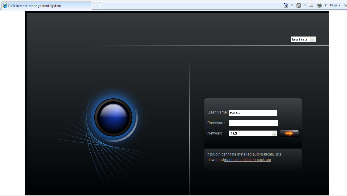

Good Day, I'm almost zeroed on sleep trying to identify and fix my CCTV to be remotely accessed, I've bought this CCTV on some local shop here in the Philippines, I would guess that this we're rebranded.
To make the story short, I can already access my CCTV from my public facing IP on Internet Explorer, the problem is the login credentials won't work, but when i login to it from the LAN, it works fine. I've already tried downgrading my Internet Explorer from ie11 to ie8, the activex controller MyNetDVR.OCX is already enabled in the add-ons.

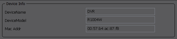

I can only show you screenshots of the DVR homepage if it would help and some screenshots of the device info page as i don't see any brands on it, there's only a H.264 DVR printed on the box

DVR Device Info Page

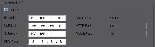

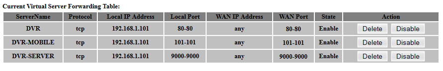

I can only see three different ports in the dvr network settings and already forwarded them on my router, I still haven't figured this one out. :/
DVR Network Settings:
Port Forward Settings:
It all looks good.
google port checker and see if it can reach your dvr on ports 80, 101, and 9000.
if you can then at least you know that the info is getting past your router to your dvr, that would then leave your set up on your mobile device or remote pc with the app you use to view the cameras.
If you cant then maybe some firewall or other thing needs configured on the router-
you need to try the app from outside your wireless so if its a mobile phone device try connecting using the 3g signal which will ensure you come in via the router to the dvr.

Hi OP,
I am just resurrecting this thread because I have encountered exactly the same issue.
Beneath "network" in your original screen (you should select LAN, not WAN), there is a button that says, "If plugin cannot be installed...."
What this means is even if you downloaded and installed the ActiveXPlugin (which i suspect you have done already) and which the DVR will attempt to do automatically, it HAS NOT installed correctly. You would not see this reference to, "install plugin" had the plugin been installed as required.
You are probably getting an authorisation login error like, "Login Failed!" rather than any reference to Active X. Very confusing.
This was a surprise to me as the first time I installed it, it appeared to install correctly, but in fact, DID NOT INSTALL CORRECTLY!
I then attempted to install this again, but it did not work.
I then tracked down the issue to the fact that MyNetDvr.ocx (and some other packages) would not install to the system32 directory. Installing to this directory is very uncommon in Windows 8 type environments -64bit (which I am running), I assume you are running something similar. However, it is common practice in older 32 bit versions of Windows.
I expect you are facing a similar issue. Unfortunately, I have not yet been able to resolve this issue.
If OP happened to resolve the issue, could you be so kind as to let me know how you did so?
