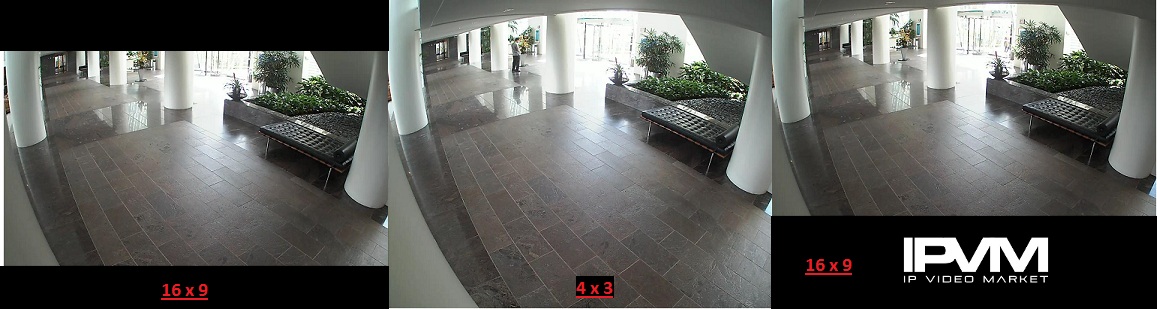

jhonovich 0 Posted November 21, 2014 For each 16:9 resolution, there is typically a 4:3 resolution alternative that has the same horizontal AoV but a greater vertical / 'tall' AoV. Like so: IPVM has a free full test report on 4:3 vs 16:9 aspect ratio coverage areas. Share this post Link to post Share on other sites
