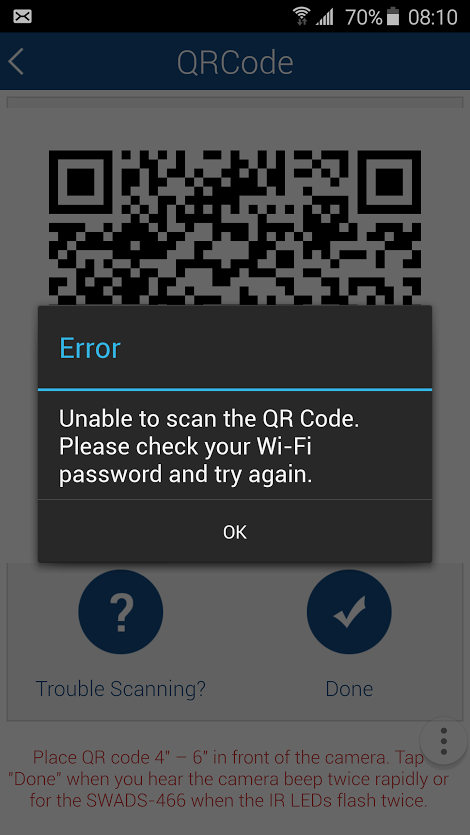

raver4444 0 Posted March 23, 2016 Hi there. Having exactly the same problem as you I think, but this is my first time I try to setup this camera. Just bought it and get this error. I do not have to mention that the Wi-Fi password is absolutely correct... IR LED flashes twice...and I can hear even the beep...but then I get this error Share this post Link to post Share on other sites
CapitalOne 0 Posted July 9, 2016 Hi All Hopefully I can be of some help here. I had exactly the same issues as stated here. I wanted to change the wireless network for the 466, so did a factory reset and tried to use the app. Registration would never work even though the camera read the QR code ok. The solution for this is to use the Swann website on a PC for the registration process and never the smartphone/tablet app (for IOS anyway). Although a bit of a pain using a full size monitor to get the QR code read, it works everytime. Before doing this I would recommend ensuring you are logged out on all devices before using the website, just in case. However, the payment gateway isn't working, but that another thing. Hope this helps. Share this post Link to post Share on other sites
