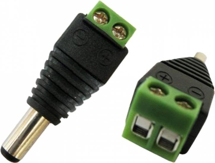

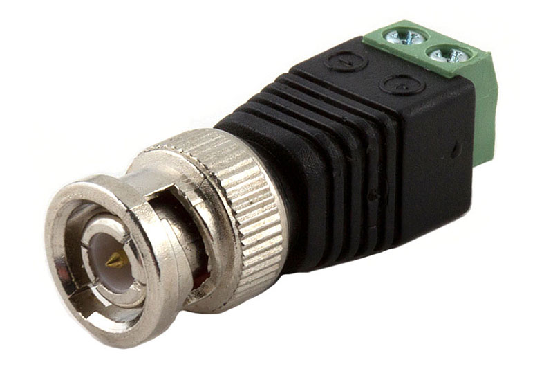

ssnapier 0 Posted December 24, 2014 You could probably use these connectors as long as you know which wires are power and which are video. You also need to know positive and negative for polarity. http://www.parts-express.com/bnc-male-to-screw-terminal-connector--090-106 http://www.cctvgold.com/Male-21mm-Power-Connector-12v-Screw-Terminal_p_1138.html Share this post Link to post Share on other sites
