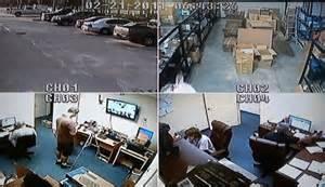

Numb-nuts 1 Posted December 23, 2014 Hi I think you are worrying about nothing at all really. Before DVRs became common, the Quad used to separate the cameras to be viewed on a single screen (MATRIX) and time slice the recording so that they apprd to be recording all at once. If you watched the tape on a standard VCR you would see quick brief images from each camera in turn. When played back using a quad these appeared quite normal. So the quad had two main functions, but nowadays modern equipment being digital, these function are combined into a single BOx. Multiplexing is also combined into one box on a DVR because they are digital. Multiplexing is performing several tasks simultaneously. Nowadays that includes several users being able to perform multiple tasks simultaneously. As I explained before, digital technology has allowed all these tasks to be combined into a single box which includes the recording function. This has transformed the CCTV recorder (DVR) into an affordable device that is not beyong the poacket or budget of a wider range of people and organizations. In terms of the future, there is no real need to worry about these functions as they are easily handled by any practical person that can read an instruction manual. a CCTV Matrix (in very basic terms) Created bt a quad Share this post Link to post Share on other sites
