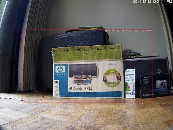

Btw.. trying the transparent trick (which I just learnt to do after years of using image editing), I found out the 1080p version of the dahua 5mp are directly taken from sensor, that is why the field of view is just one half, while that of 720p are compressed smaller from the original image (with D1 they took the center image and make it smaller). The 3mp version of the 5mp are taken directly from sensor with about 10% increase so the field of view is still half of the 5mp. I see more details at night in the 3mp 4300s than the 5mp that was why I returned it (let's ignore the 5mp for now as we focus on the exposure vs fov mystery). Thanks.
to continue above, the following is what occurred when the dahua 5mp and its 1080p setting (in red rectangle) is overlap transparently (just learnt this trick from Maxicon.. thanks and sorry for the off topic).
This is another case of having to figure out what they're doing in the firmware, which isn't easy, and doesn't always make sense. You have to test it to know for sure.
Typically, they use the entire image to calculate exposure, and when you include more pixels in an increased FOV, those pixels are now used as well. If it's sampled, the groups of pixels have different averages than the individual pixels, which can also change the exposure setting.
In my Dahua image, the exposure is darker at 3MP because it includes more of the sky, which is brighter, and I have auto-exposure enabled. Is your Dahua image fixed exposure on both? It appears so, because they match quite closely.
No telling why Dahua chose to directly sample some and scale others - this makes no sense, and causes customer confusion and unhappiness. Most sensors/processors have sampling commands built in to generate full FOV images of lower resolutions, so they didn't even have to do any special work to implement it.
At least now you know what's happening!
