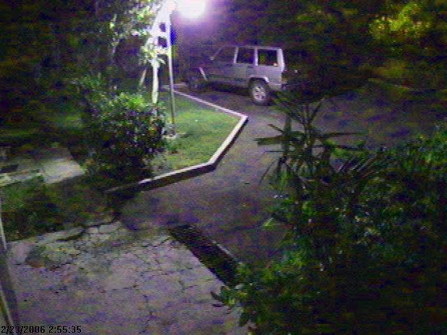

Someone mentioned on another thread about how their Denterlace was worse quality than Interlace so i post these here and you guys can make up your minds ...
640x480
640x480 DeInterlace
720x480
720x480 DeInterlace

Adjusted to bring out distortion:
Interlaced:
Deinterlaced:
Interlaced looks better in this snapshot with the detail brought out. But what are the file size differences? How many people could see that much of a difference before the images were enhanced?

640x480
640x480 DeInterlace
720x480
720x480 DeInterlace
Is it just me or doesn't every single image market "DeInterlaced" looks all interlaced to hell. I mean the curb at Rory's house looks like stairs! That hasn't been deinterlaced properly, then the supposedly interlaced images all look smooth. That curb isn't moving, no need for that.
Think this might be a labeling issue?
I was thinking that it may be a labelling mistake aswell. Isn't De-Interlaced images supposed to look better?
I have watched live video and still images on the de-interlaced resolution and the quality is very poor compared to the Interlaced.
