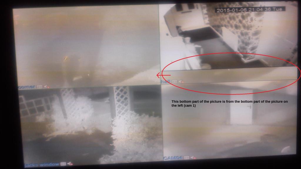

Hach69 0 Posted January 6, 2015 Hi, i'm new here and was hoping someone could shed some light on why i have this problem..?(see pic) Searched everywhere but cant find any answer anywhere.. For some reason on one of my cameras there is an extra bit showing that is part of one of the other cameras. One of the cams is outside and the other is inside. Share this post Link to post Share on other sites
Excalibur 0 Posted January 7, 2015 Could that camera have a resolution setting too high or perhaps different from the others so the viewer doesn't know how to handle the situation. Just a thought. Share this post Link to post Share on other sites
Hach69 0 Posted January 7, 2015 Thanks, will have look into that later today after work. Atm out of 4 cams this one is the only bubble cam indoors, could be a setting, although when ive connected a second bubble cam to test, I dont thinkI had the same prob. I also swapped this cam and tried another, same thing happened. As I say I will look more into some settings later. Thanks. Share this post Link to post Share on other sites
Hach69 0 Posted January 11, 2015 Problem solved....! Changed a setting from PAL to NTSC.... Share this post Link to post Share on other sites
