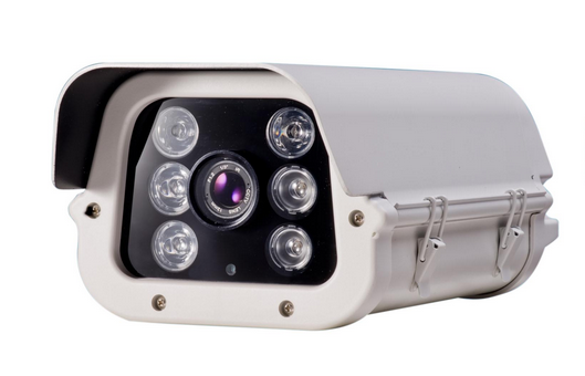

davidhuber0812 0 Posted January 13, 2015 That is too far. Lately, I did have similar experience, but a little different. It was an IP Camera, which was specially designed for us by the manufacturer. 960P(1280*960) resolution, they installed 6pcs array lights for me, 16mm lens. I got about 400-500m distance, even the night vision distance is about 300 or so. That was for my customer's residential fence. It costs us $127 per piece. Check out here Share this post Link to post Share on other sites
