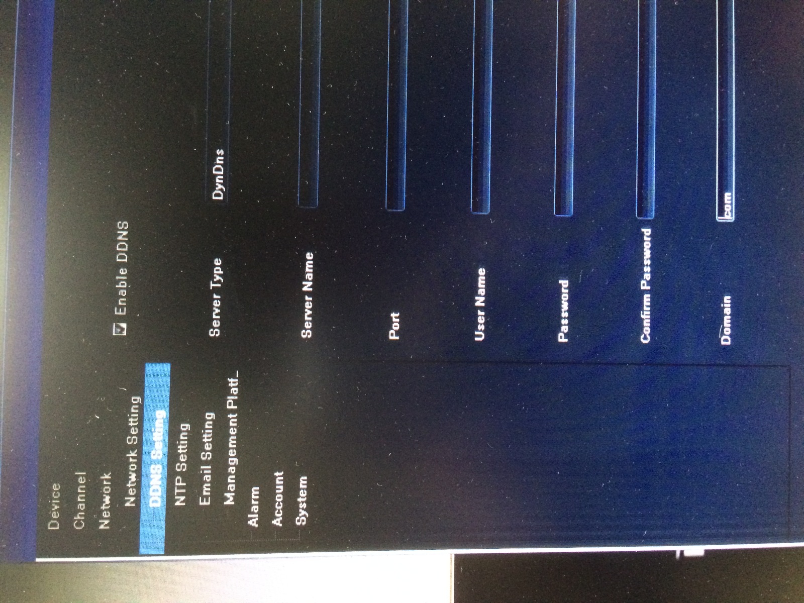

poor_red_neck 0 Posted January 19, 2015 Very simple. You'll need to setup port fowarding on your router. You need to find the port number that your NVR uses for viewing on your phone (since it is working on your local setup, it's whatever port number is currently working). Google your Cisco routers' model number then port forwarding. For example if you have a RV110W then you would google "Cisco RV110W Port Forwarding Tutorial" Is it a residential grade router or a business/commercial router? Post the model number and I'll see what I can do to help. Just as a FYI, the screenshot you posted is what's called "Dynamic DNS" This is used so you don't have to remember what your IP address is, or if you IP address changes often. Most cable modems now use a semi static IP. It won't change unless you do a hard reset on your modem, or if they're doing alot of work in the area and bring down the neighborhood router. Still I have a static IP but use a dynamic DNS solution so I don't have to remember the IP address. If you want to learn more about dynamic dns just google it, there is PLENTY of information out there. Looks like your NVR supports it natively. This means the NVR will check what your external IP address is, and will update automatically. 99% of these services are free, you just need to use the service that your NVR supports. Mine supports no-ip.com and that's what I use. Share this post Link to post Share on other sites

poor_red_neck 0 Posted January 23, 2015 Simply setting up a DDNS will not allow him to access from outside the local network unless the NVR and router support UPnP. Even then ive never had UPnP wirk reliably. Best option is to forward ports. All DDNS does is turn an IP address into a legible domain name, and update that DNS registry should your ip address change (hence the dynamic). Share this post Link to post Share on other sites
