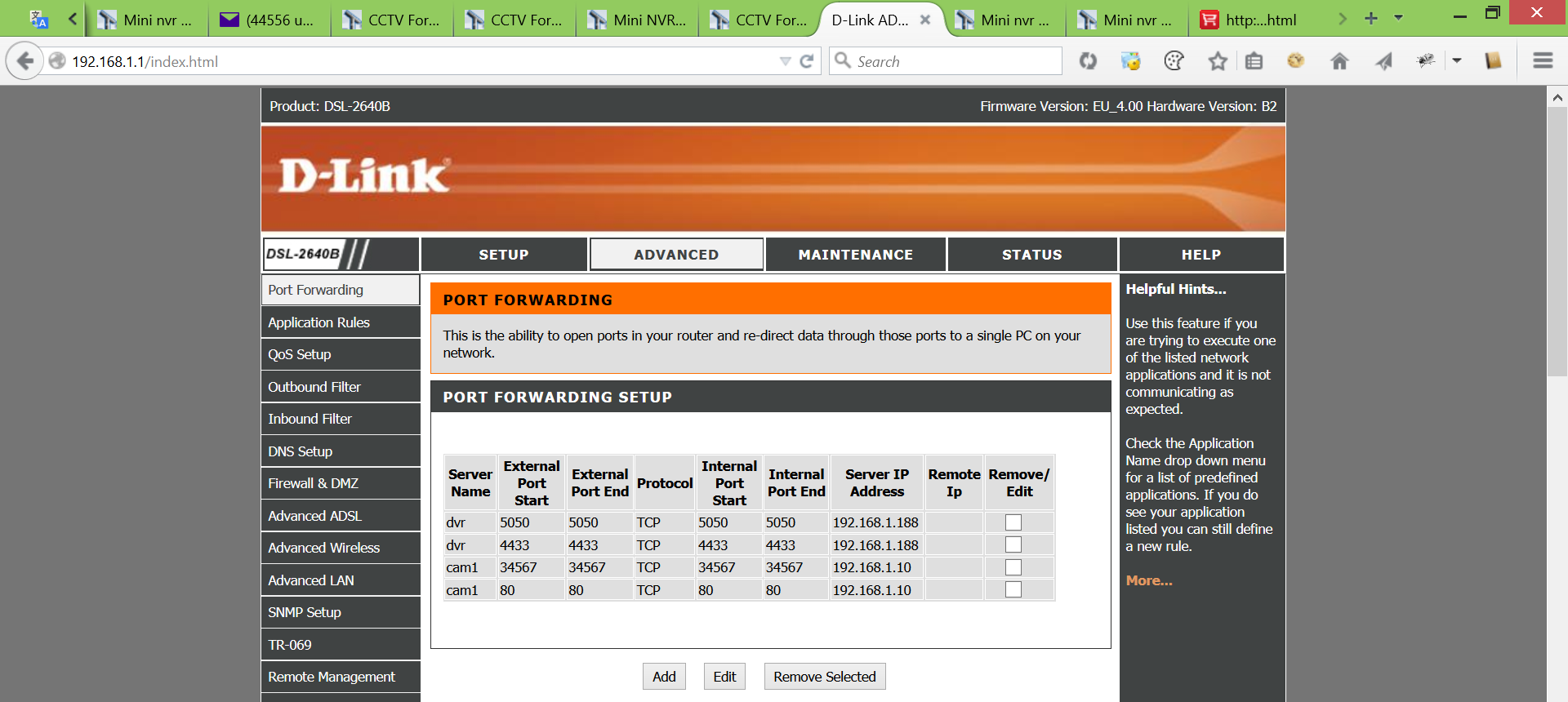

I configured the port forwarding in my dlink router (set it 5050)
I test it using canyouseeme show me I can see you 5050
nvr configuration
when I fill my 42.54.65.76:5050 in internet explorer not respond at all
please tell me where I'm wrong

Check DHCP box in your last screen about the network settings and configure the ports again with your new internal IP. Probably, you have to forward at least the following ports 80, 5050,5051,5052,5053. To access the web interface of your camera you have to put in the following >>>External_IP:80. <<<
To use vMeye you have to put in port 5053 in your case assuming that the backend of your mini nvr is the same as in the other topic.

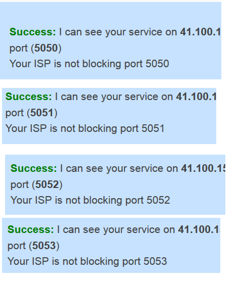

Could you look if port 5050 is open at the following site: http://www.canyouseeme.org/
Besides 5050, you have to open 5051, 5052 and 5053 for the mini nvr. Could you show me where you bought your nvr, since the GUI is diffent compared to mine.
I tested with canyouseeme website all ports are working

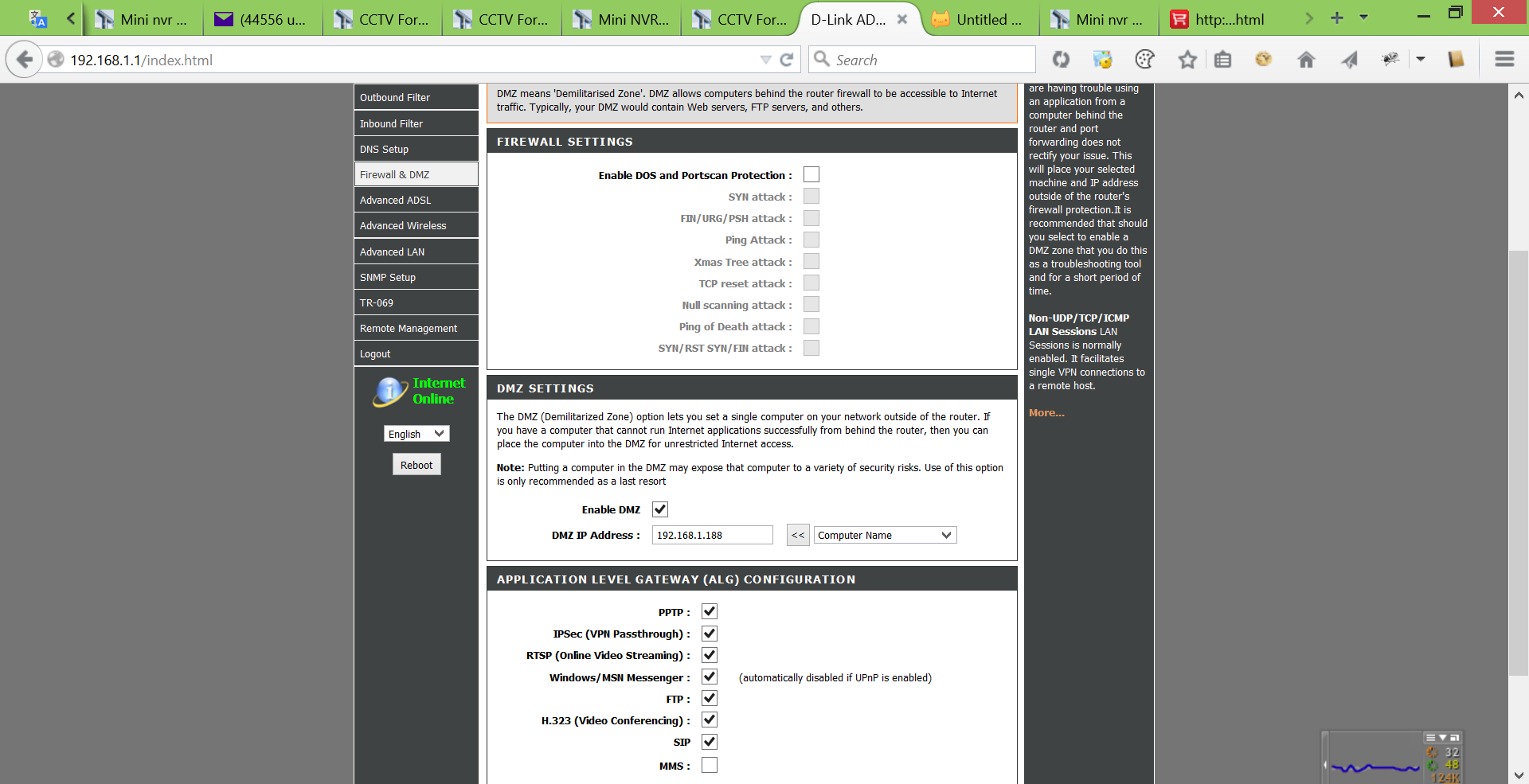

Strange, could you change port 80 to 90 from your NVR instead of your camera and forward port 90? So you can try External_IP:90?
Furthermore, you need External_IP:HTTP_port or External_IP:HTTPS_port to access the web interface of your nvr. So in your case you need>>> External_IP:4433 for HTTPS
For using mEye/vMeye or an other mobile app to watch your cameras you need port 5053 (so Device port + 3).

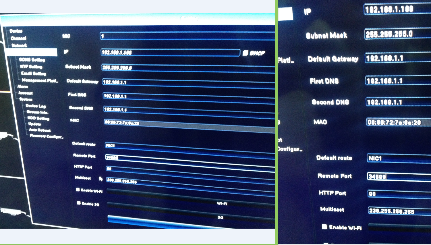

my display is different because I took the photos from internet explorer but using TV the interface is the same like you
look those 2 photos and check if any parameter is wrong
this image is from my TV
this image is from internet explorer
also I changed it from 80 to 90 and tested the local address of nvr from internet explorer 192.168.1.188:90 it open the nvr but when I use my ip address 41.43.232.214:90 not load at all
Ah okay, that makes sense .
Could you try do check DHCP box using the TV interface and change the internal IP address in your settings of the modem. My modem did not accept the static IP of 192.168.1.188 (or any other static IP done by a device) of the NVR for forwarding ports. Only when I changed the network settings to DHCP I was able to use the vMeye app outside my home.

there is 2 problem
1st problem is when I open my public ip:80 http in browser in another network I can open it and when I open it in my network I can't use
2nd problem is why only the http port is working because the smartphone app need the device port and can't get it working with device port I already set it to 34599

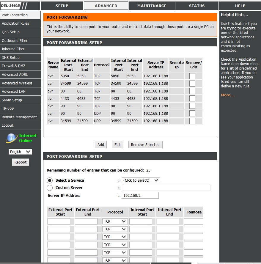

Based on HTTP port 80, Remote port 34599 and internal IP 192.168.1.8
Please try the following settings in your Dlink modem as described in the picture. You need to forward all the ports since these are necessary for the NVR to broadcast the pictures, so HTTP port, Remote port, Remote port +1, Remote port +2 and Remote port +3. So in total, you have to forward 4 ports. For the app vMeye on Android or Apple you need Remote port +3, so in your case 34602, to get it work.
After you have forwarded the ports, the following are needed to access your NVR:
Internal_IP:80 for internal network: 192.168.1.8:80
External_IP:90 for external network
If you want to use the same port for the internal and external network, please change the HTTP port in the NVR to 90. The first line in the DLink should then be: dvr http 90 90 90 90 192.168.1.8
