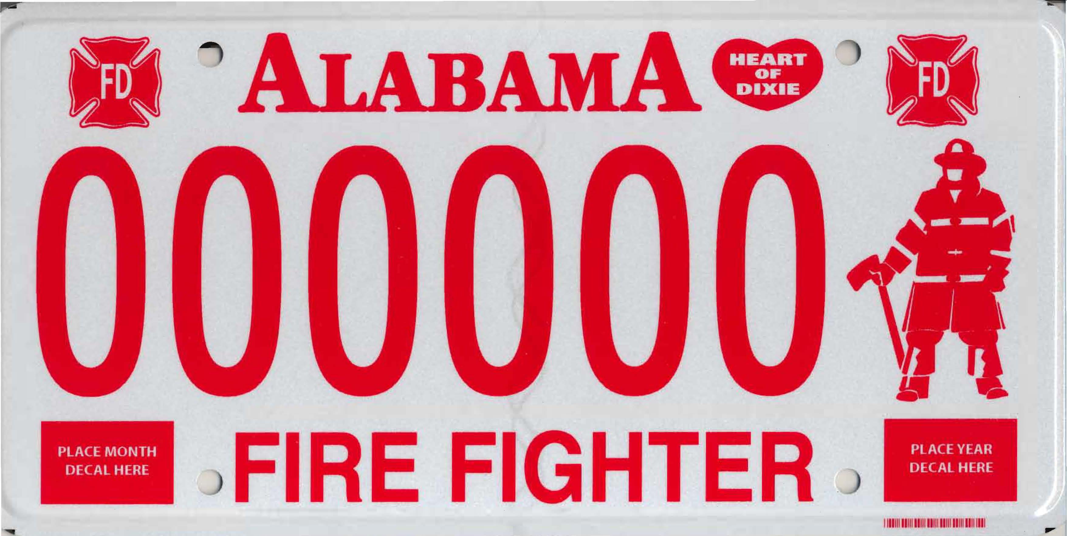

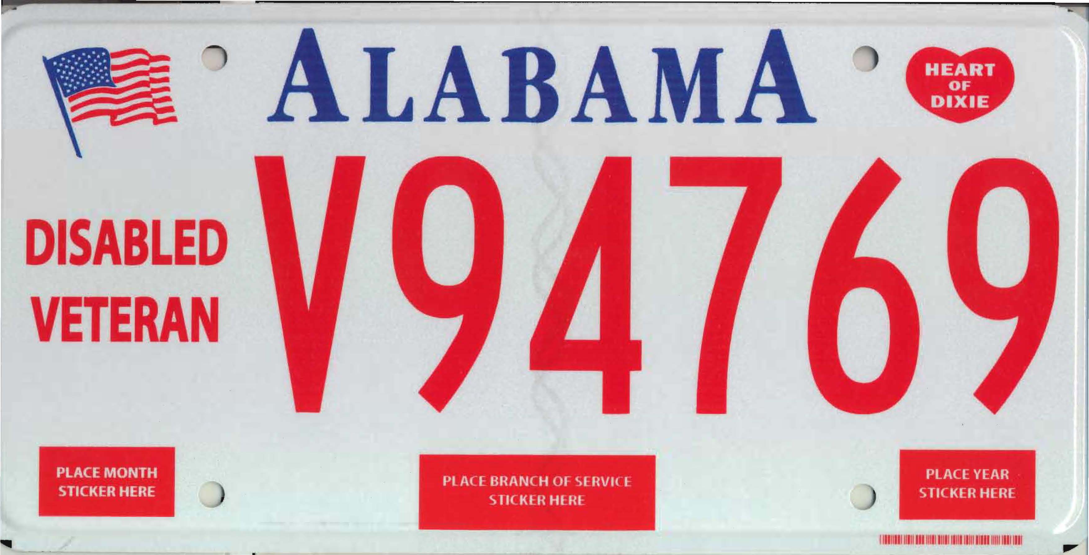

I had a 30 minute visit with the parking services people at one of the Universities I do service work at.
They cruse the parking lots with a Auto vu system with the Sharp X cameras. I asked them if they had any trouble with plates that had red letters. Alabama Disabled Vets and Volunteer Fire Fighters tags are red letters. They said absolutely not.
They said the have more trouble with Florida and Georgia Tags with the Peach or the Orange in the middle giving them bogus numbers.

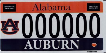

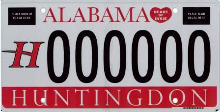

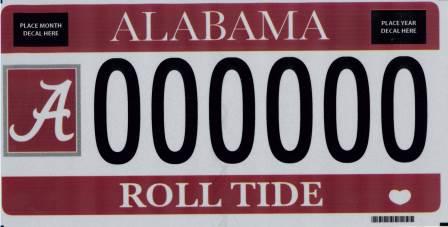

They have problems with the University Tags like this picking up the additional letters.
Sure, because it's not an IR sensitive camera, so I would expect it to read red. It's all the IR sensitive cameras that have issues with red. Also, when they cruise the lot, I'm wondering if there's a search light or head light that shines on the plate or just light from the camera itself.
Just the IR from the camera.
They are doing both sides at the same time.
They are doing it by zones. If the car isn't registered for that zone it pops.
If they don't pay their ticket then it will pop for that and then it gets booted.
