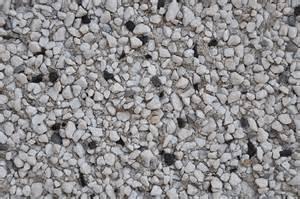

I suppose I should be grateful it wasn't a mains cable? I was drilling from the outside in since the wall face is pebble-dashed ( a sort of cement render finished in small stones embedded into the surface) and going outwards on render would risk blow out of abig chunk of the render. The client was very understanding and was happy when I left since I prioritized restoring his Sky TV cables. A sort of twinax RG58 not the same RG58 used in 2 way radio, much thinner. I found the cable in B & Q and the f type connectors in Maplin fortunatly.

Under the pebble dash is 3 inches of insulation board, that's a problem will have to solve tomorrow fixing to the masonry through 3 inch foam board.

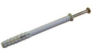

I am planning on using 110mm hammer in fixings anything you've used that worked well and can recommend I'd be grateful.

Pebble dash rendering.........................................Hammer in fixings

Anyway, the hammer in fixings worked a treat, so I am a little happier today.
We're abouts was you working, I'm a sky engineer so could of fixed it for you, we always drill inside out, I take it off hammer last 3 inches or so and never burst the render, you've got a higher risk of bursting the plaster off as it's not as thick
