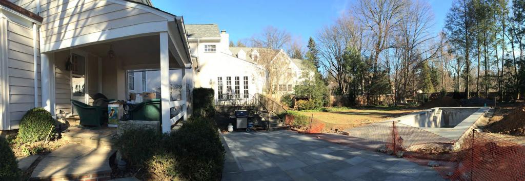

charlie135 0 Posted February 1, 2015 The pool is 20 x 40, but the recording area is probably 40 x 70. It does not need to be hidden, but I also do not want a big pelco housing. The camera is basically an "insurance policy" in case anyone were to sneak in and become injured in the pool, I want to be able to have a record, and also be able to log in and check the area when I am away. It will record 24/7 and does not need to record on motion, but the feature would be nice down the road. Right now, I really do not want to have cameras all over the place, but perhaps down the road I might add some more (so expandability would be nice). The camera will be mounted under a third story roofline. I want to monitor directly adjacent to the pool, and the camera can be mounted in parallel line with the pool, or off to the side. Here is the pool Share this post Link to post Share on other sites

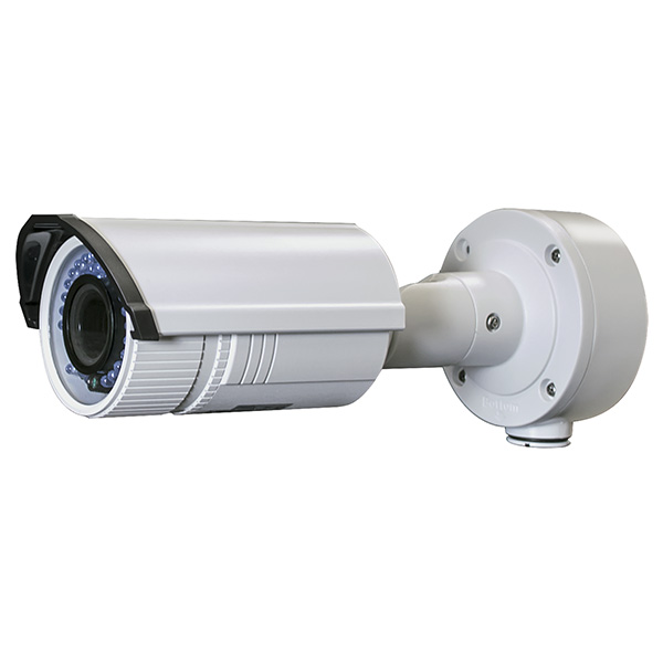

charlie135 0 Posted February 1, 2015 Was hoping to get a camera that looks something along these lines: Share this post Link to post Share on other sites

Boogieman 1 Posted February 1, 2015 The camera in your photo is a hikvision 2632 that has varifocal and sd card slot...you can record directly to the card..set up motion and a 32gig card easily last a week or more. Share this post Link to post Share on other sites
charlie135 0 Posted February 1, 2015 The camera in your photo is a hikvision 2632 that has varifocal and sd card slot...you can record directly to the card..set up motion and a 32gig card easily last a week or more. I want to have 24/7 recording. Share this post Link to post Share on other sites
