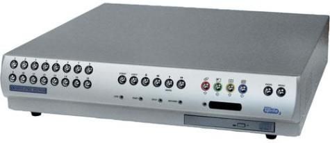

mikeylaw81 0 Posted February 10, 2015 Hi guys I don't know much about these systems iv just switched from a very basic cheap dvr which was very easy when it came to attaching a Ptz camera basically the two pins plugged into the green rs485 port on the back and that was it all gogo. Now iv just bought this Dm sprite 2 from ebay its a 9ch 160gb with built in CD. Simple question is how do I connect my Ptz camera to this Dvr ? Its an unbranded cheap Chinese ptz which works really well believably and it was working on Pelco d setup. Any help would be very appreciated Thanks Share this post Link to post Share on other sites

cctvmann 0 Posted February 11, 2015 hi i can help you get your ptz working through the dm, you need to setup the dm to serial port 4 and the dm uses 9600 baud rate on pelco p you need a way of changing thwe ptz address settings etc Share this post Link to post Share on other sites
mikeylaw81 0 Posted February 11, 2015 Is it a case of the two pins from the ptz go into the serial port then ? Share this post Link to post Share on other sites
cctvmann 0 Posted February 12, 2015 Is it a case of the two pins from the ptz go into the serial port then ? yes there should be a green block connector on the back of the dm. Share this post Link to post Share on other sites
mikeylaw81 0 Posted February 12, 2015 Thanks for that I'm not home untill tomorrow and I'm sure I remember seeing two green blocks which one would it be ? Share this post Link to post Share on other sites
cctvmann 0 Posted February 12, 2015 Thanks for that I'm not home untill tomorrow and I'm sure I remember seeing two green blocks which one would it be ? itll be serial4 rs485 Share this post Link to post Share on other sites
mikeylaw81 0 Posted February 12, 2015 I guess that's the one that says Bus A and Bus B so would I just use Bus A say so ? Share this post Link to post Share on other sites
mikeylaw81 0 Posted February 13, 2015 Right guys thanks for all your help iv managed to suss the ptz problem was just a case of selecting pelco-p in the menus and placing to 2 pins into the green block Next question Is there an easy way to upgrade to version 4.0 (86) without using a crossover cable because I haven't a clue what that is. Im currently on 3.1 (165) - Net (DVTX) Share this post Link to post Share on other sites
