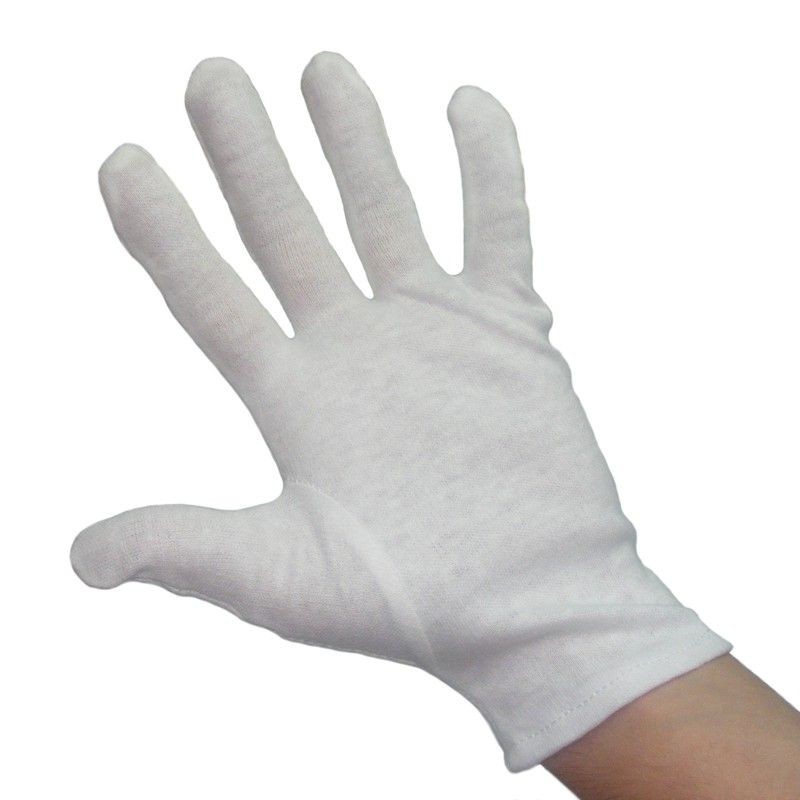

You may have also noticed that this type of camera is often supplied with a cotton glove so that alone should indicate they require careful handling.
NEVER touch the inside (or outside) of a polycarbonate dome with bare hands or if you do clean it as soon as you can afterward
