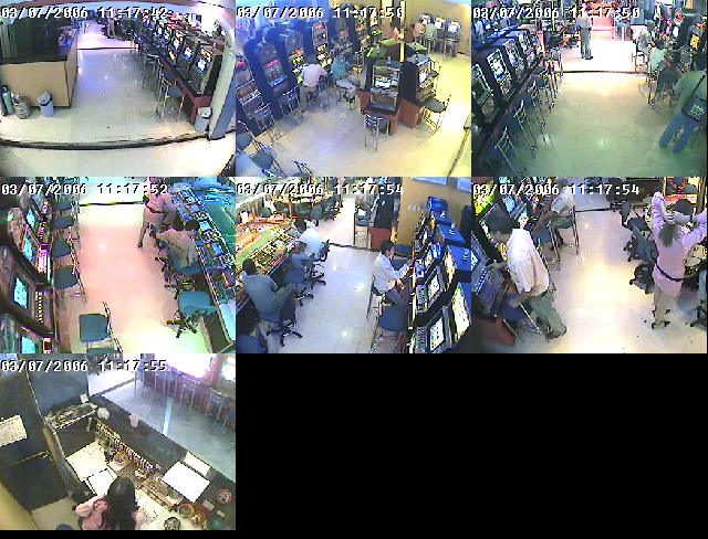

kandcorp - would it be possible to see larger versions of those images? (me being nosy ) and also what cams are those ?
regards,
sam
mace? dont think ive heard of those in the uk unless im going mad. good cams? looks like nice images from what i can see
Here are some bigger shots. Keep in mind recording is in 352x240 and the image quality is set almost to the lowest due to the cheap PC setup. Yes Rory, I guess you could call it a Mace Cam. They have the same camera (Cam57FHI). Oh, the cams are 1/3" Sony 420TVL:

They are a big OEM CCTV company based out of Florida. They have some decent cameras for decent prices. More DIY type stuff.
As far as the images they look pretty good considering the DVR setup. Probably would look better at higher resolution and image quality settings. for the money not bad at all.
hurts my poor eyes
reminds me of a colleagues install down here, he did all 14 wendies with eclipse CCTV's cheapest cameras ... i just couldnt look at them anymore .. i felt so depressed ..
I know what you mean . But, if your on a budget and it's between these and some monitor powered RJ-11 Cameras from Sam's Club or Costco...I would choose these. There not as bad as I have seen before. Hey, at least there not using a cmos 140TVL sensor .
