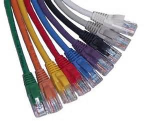

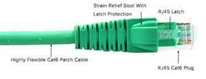

Unless you too wish to view the property remotely you could always unplug it from the internet router.
Look at the back of the CCTV recorder DVR and look for a modular plug like the one pictuured below. Simply press the latch down and pull the plug out. Now the Images are not accessible outside your home.
