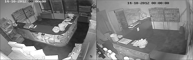

left cam ok but right one little fogy
Same type of camera

Problem was the ir light find the way to the lens internally
You can fix this with a rubber o ring to isolate the lens.
