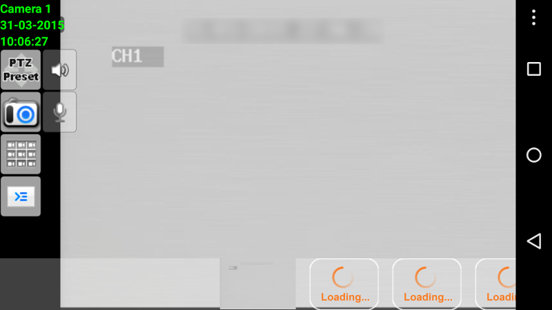

I have an old (and cheap) ZModo 4-channel system (Model D9104BH - SKU# DVR-H9104V).
I just recently installed and configured it, and while I can't monitor the cameras through the browser (the built-in webserver seems to use an ancient Active-X module), I got it to work with the IP Cam Viewer app on Android (using its "Scan Camera" function).
Everything works pretty well (considering it's a cheap system), except for two out of the four cameras.
This is what they show with daylight (the other two identical cameras are perfect):
During the night, all four cameras work just fine.
I have already purchased higher quality CCTV cables and replaced them.
I have also ensured that the cables don't touch any major electrical line. No luck.
Any ideas? TIA!

Thank you for the reply, sorry for my delay in following up.
Yes, I tried swapping them at the DVR, same result. The "static" images moved from CH1,2 to CH3,4
Looks like the iris control is NFG! (stuck on open)...
