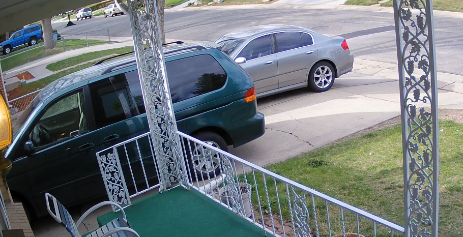

Kyle_Gates 0 Posted April 15, 2015 So, just an observation here. I recently decided to get into some very basic home security. I went ahead and purchased the Lorex LW-2962H system (2 wireless cams with 2 way audio and micro SD recording). I will say I really liked the whole 2-way audio gimmick but the video seemed like there could be improvement. Well, I had made said purchase on a whim before doing any real research. After a week of doing said research I decided to go a different route. First off, wired seemed to be the way to go. More invasive install sure but, just seemed like it was better all the way around. In the end, I went with: Two HikVision DS-2CD2032-I's (Bullet, 3mp, 3mm, POE) One HikVision DS-2CD2332-I (Dome, 3mp, 2.8mm, POE) One TP-LINK TL-SF1008P (8 Port POE switch (only 4 ports are POE) Total cost, around $350 (I did already possess all the CAT 6 cabling I needed and all tools required for running said cable. I also already have a 20 TB server up and running so I will not need to purchase equipment to record too.) Finished the setup today and so far am very impressed. Might not be what you can get by dropping multiple thousands but is lightyears beyond many of the "all-in-one" systems I looked at first. I'll see about getting some footage up so those interested can take a peek. In the meantime I took a quick screen grab of the outdoor cam: Share this post Link to post Share on other sites
