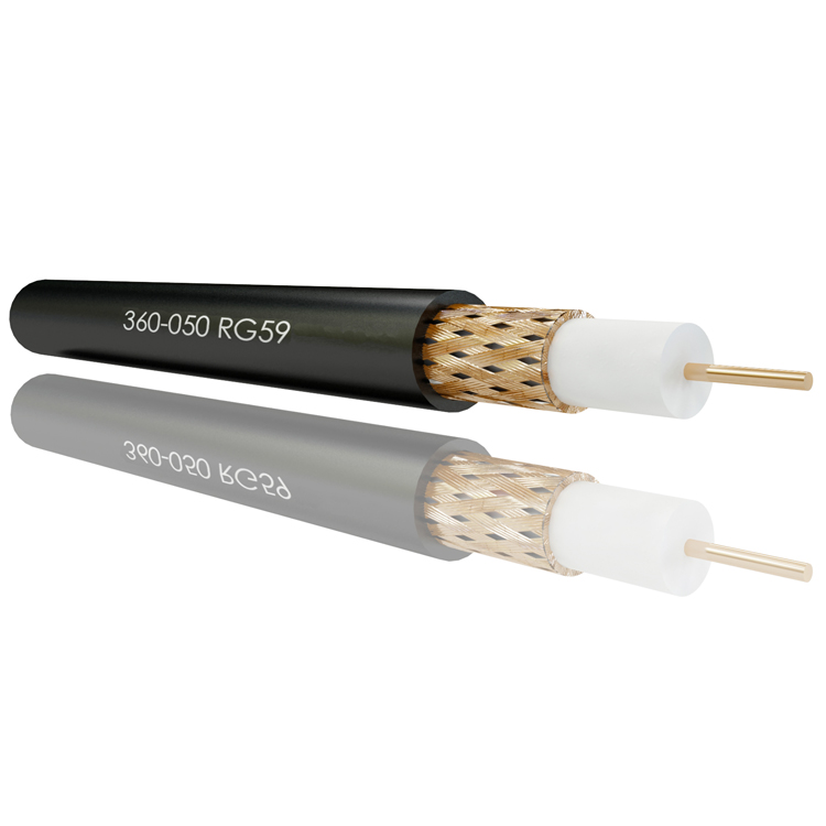

Buy 100m of siamese or shotgun and make your own cable
Watch out for voltage drop. You might be better off powering the camera more locally
and just run RG59 which is easier to work with and lighter to handle.

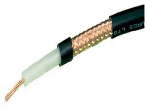

I actually made a 100M run with (gulp) URM70 which is a (stranded center cable) it was all that was available.
The result was surprisingly good, ( well it is 75 OHM cable) but don't you do it as it's mainly for making small
patch leads as its so flexible.
