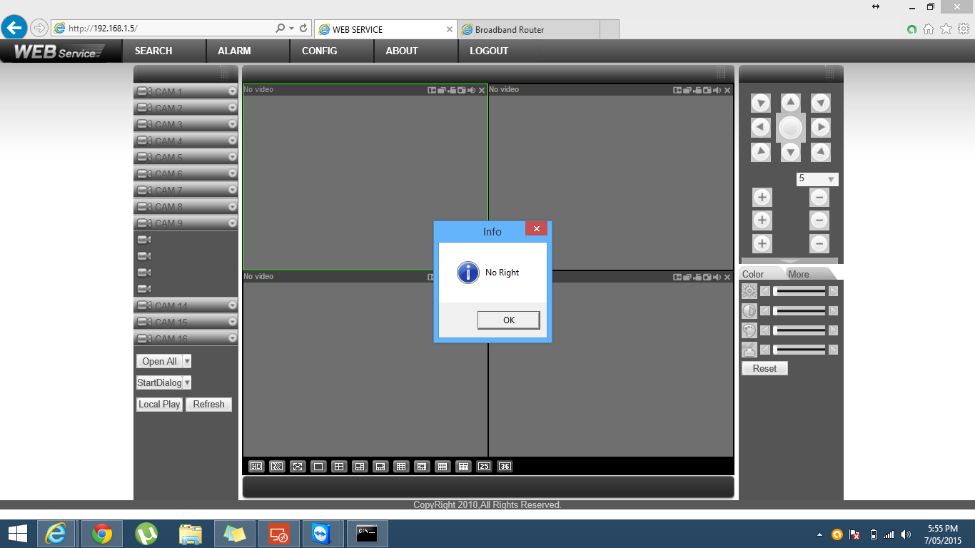

I have a DAHUA DVR, I am using Web Service 2.0 and when I tried to see cameras message "No right" comes up. I already verify that "Admin" user has the right to monitor.

I'm having the exact same issue. Driving me crazy. I've tired new users, reboots of everything, turning on IP filter with a local address, tried accessing locally, remotely and no luck. Found this issue mentioned a few other places but no solutions. Anyhow you're not the only one ahaha.

Maybe you need check the user's permission in DVR,if the user is prohibited to use IE to view DVR ,this will be come up the situation you have seen.

go to account management and delete the account name "system", the problem will be solved . With firmware 3.2.... you could do it through network, with older version (2.6...) must do directly on dvr

let do it, delete account name "system", don't be worry, the only effection is that "no right" notice is no more exist and you can use your DVR as normal )

some people on this forum say that because of the security, dahua do this to make it's customers to change the default password , but i found that even change the device's default password to something, the problem would happen again !

Hi so I deleted the system user and got my visuals online BUT after a wile the system user keeps coming back anf the No Right message re-appears .

Hello, you need to check all right cases of the system user. in the memo you will find ( your account has been hacked )
i think the security system did block all the admin accounts because he felt that someone else did try to access to your dvr.
