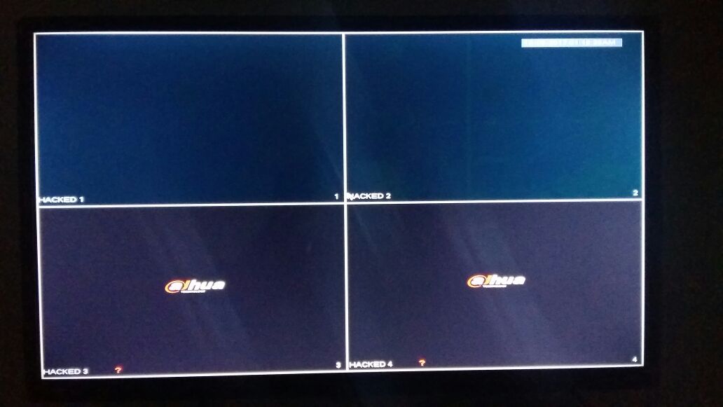

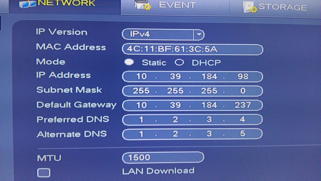

GPSOFT 0 Posted September 16, 2017 Dahua's 888888 account is only for local access, it can only be used with a monitor and mouse plugged on the unit. It can not be used from network. Dear sir My dvr hack what can i do sir?? every 2 or 3 hour its hack after hack tcp ip settings lost and all channels saw HACKED 1 what is the proper way to solve this Share this post Link to post Share on other sites
smsm2002002 0 Posted September 18, 2017 Dear sir My dvr hack what can i do sir?? every 2 or 3 hour its hack after hack tcp ip settings lost and all channels saw HACKED 1 Zoom in (real dimensions: 1032 x 581)Image Zoom in (real dimensions: 1032 x 581)Image Image what is the proper way to solve this same error Share this post Link to post Share on other sites

oh6hfx 0 Posted September 22, 2017 My client has NVR-5232 and had it was hacked last evening (21.9.17). I can confirm also that hacker has accessed the device with user account 888888 via network. There were no default passwords in NVR. According to log, everything was done just in 2 minutes. When I arrived the site all the cameras were offline and in spare channels I could see HACKED in the channel name. Also PPPoe settings was written "HACKED". Also hacker had changed some settings in all 7 cameras. I had to plug them in one by one and updating fw with configtool before I could get any video out. Here a clip from the log: 37 17-09-21 21:10:49 888888 User logged in IP Address: 89.34.79.84 User: 888888 38 17-09-21 21:10:49 888888 Save Save COLOR SETTING Config! IP Address:89.34.79.84 39 17-09-21 21:10:49 888888 Save Save COLOR SETTING Config! IP Address:89.34.79.84 40 17-09-21 21:10:49 888888 Save Save COLOR SETTING Config! IP Address:89.34.79.84 41 17-09-21 21:10:49 888888 Save Save COLOR SETTING Config! IP Address:89.34.79.84 42 17-09-21 21:10:49 888888 Save Save COLOR SETTING Config! IP Address:89.34.79.84 43 17-09-21 21:10:49 888888 Save Save COLOR SETTING Config! IP Address:89.34.79.84 44 17-09-21 21:10:49 888888 Save Save COLOR SETTING Config! IP Address:89.34.79.84 45 17-09-21 21:10:49 888888 Save Save COLOR SETTING Config! IP Address:89.34.79.84 46 17-09-21 21:10:49 888888 Save Save COLOR SETTING Config! IP Address:89.34.79.84 47 17-09-21 21:10:49 888888 Save Save COLOR SETTING Config! IP Address:89.34.79.84 48 17-09-21 21:10:49 888888 Save Save COLOR SETTING Config! IP Address:89.34.79.84 49 17-09-21 21:10:49 888888 Save Save COLOR SETTING Config! IP Address:89.34.79.84 50 17-09-21 21:10:49 888888 Save Save COLOR SETTING Config! IP Address:89.34.79.84 51 17-09-21 21:10:49 888888 Save Save COLOR SETTING Config! IP Address:89.34.79.84 52 17-09-21 21:10:49 888888 Save Save COLOR SETTING Config! IP Address:89.34.79.84 53 17-09-21 21:10:49 888888 Save Save COLOR SETTING Config! IP Address:89.34.79.84 54 17-09-21 21:10:49 888888 Save Save COLOR SETTING Config! IP Address:89.34.79.84 55 17-09-21 21:10:49 888888 Save Save COLOR SETTING Config! IP Address:89.34.79.84 56 17-09-21 21:10:49 888888 Save Save COLOR SETTING Config! IP Address:89.34.79.84 57 17-09-21 21:10:49 888888 Save Save COLOR SETTING Config! IP Address:89.34.79.84 58 17-09-21 21:10:49 888888 Save Save COLOR SETTING Config! IP Address:89.34.79.84 59 17-09-21 21:10:49 888888 Save Save COLOR SETTING Config! IP Address:89.34.79.84 60 17-09-21 21:10:49 888888 Save Save COLOR SETTING Config! IP Address:89.34.79.84 61 17-09-21 21:10:49 888888 Save Save COLOR SETTING Config! IP Address:89.34.79.84 62 17-09-21 21:10:49 888888 Save Save COLOR SETTING Config! IP Address:89.34.79.84 63 17-09-21 21:10:49 888888 Save Save COLOR SETTING Config! IP Address:89.34.79.84 64 17-09-21 21:10:49 888888 Save Save COLOR SETTING Config! IP Address:89.34.79.84 65 17-09-21 21:10:49 888888 Save Save COLOR SETTING Config! IP Address:89.34.79.84 66 17-09-21 21:10:49 888888 Save Save COLOR SETTING Config! IP Address:89.34.79.84 67 17-09-21 21:10:49 888888 Save Save COLOR SETTING Config! IP Address:89.34.79.84 68 17-09-21 21:10:49 888888 Save Save COLOR SETTING Config! IP Address:89.34.79.84 69 17-09-21 21:10:49 888888 Save Save COLOR SETTING Config! IP Address:89.34.79.84 70 17-09-21 21:10:49 888888 Save Save NETWORK Config! IP Address:89.34.79.84 71 17-09-21 21:10:49 888888 Save Save DNS Config! IP Address:89.34.79.84 72 17-09-21 21:10:49 888888 Save Save IPV6 DNS Config! IP Address:89.34.79.84 73 17-09-21 21:10:49 888888 Save Save DISPLAY Config! IP Address:89.34.79.84 Channel:8 Channel Display :CAM 8-->HACKED 8 74 17-09-21 21:10:49 888888 Save Save DISPLAY Config! IP Address:89.34.79.84 Channel:9 Channel Display :CAM 9-->HACKED 9 75 17-09-21 21:10:49 888888 Save Save DISPLAY Config! IP Address:89.34.79.84 Channel:10 Channel Display :CAM 10-->HACKED 10 76 17-09-21 21:10:49 888888 Save Save DISPLAY Config! IP Address:89.34.79.84 Channel:11 Channel Display :CAM 11-->HACKED 11 77 17-09-21 21:10:49 888888 Save Save DISPLAY Config! IP Address:89.34.79.84 Channel:12 Channel Display :CAM 12-->HACKED 12 78 17-09-21 21:10:49 888888 Save Save DISPLAY Config! IP Address:89.34.79.84 Channel:13 Channel Display :CAM 13-->HACKED 13 79 17-09-21 21:10:49 888888 Save Save DISPLAY Config! IP Address:89.34.79.84 Channel:14 Channel Display :CAM 14-->HACKED 14 80 17-09-21 21:10:49 888888 Save Save DISPLAY Config! IP Address:89.34.79.84 Channel:15 Channel Display :CAM 15-->HACKED 15 81 17-09-21 21:10:49 888888 Save Save DISPLAY Config! IP Address:89.34.79.84 Channel:16 Channel Display :CAM 16-->HACKED 16 82 17-09-21 21:10:49 888888 Save Save DISPLAY Config! IP Address:89.34.79.84 Channel:17 Channel Display :CAM 17--> 83 17-09-21 21:10:49 888888 Save Save DISPLAY Config! IP Address:89.34.79.84 Channel:18 Channel Display :CAM 18--> 84 17-09-21 21:10:49 888888 Save Save DISPLAY Config! IP Address:89.34.79.84 Channel:19 Channel Display :CAM 19--> 85 17-09-21 21:10:49 888888 Save Save DISPLAY Config! IP Address:89.34.79.84 Channel:20 Channel Display :CAM 20--> 86 17-09-21 21:10:49 888888 Save Save DISPLAY Config! IP Address:89.34.79.84 Channel:21 Channel Display :CAM 21--> 87 17-09-21 21:10:49 888888 Save Save DISPLAY Config! IP Address:89.34.79.84 Channel:22 Channel Display :CAM 22--> 88 17-09-21 21:10:49 888888 Save Save DISPLAY Config! IP Address:89.34.79.84 Channel:23 Channel Display :CAM 23--> 89 17-09-21 21:10:49 888888 Save Save DISPLAY Config! IP Address:89.34.79.84 Channel:24 Channel Display :CAM 24--> 90 17-09-21 21:10:49 888888 Save Save DISPLAY Config! IP Address:89.34.79.84 Channel:25 Channel Display :CAM 25--> 91 17-09-21 21:10:49 888888 Save Save DISPLAY Config! IP Address:89.34.79.84 Channel:26 Channel Display :CAM 26--> 92 17-09-21 21:10:49 888888 Save Save DISPLAY Config! IP Address:89.34.79.84 Channel:27 Channel Display :CAM 27--> 93 17-09-21 21:10:49 888888 Save Save DISPLAY Config! IP Address:89.34.79.84 Channel:28 Channel Display :CAM 28--> 94 17-09-21 21:10:49 888888 Save Save DISPLAY Config! IP Address:89.34.79.84 Channel:29 Channel Display :CAM 29--> 95 17-09-21 21:10:49 888888 Save Save DISPLAY Config! IP Address:89.34.79.84 Channel:30 Channel Display :CAM 30--> 96 17-09-21 21:10:49 888888 Save Save DISPLAY Config! IP Address:89.34.79.84 Channel:31 Channel Display :CAM 31--> 97 17-09-21 21:10:49 888888 Save Save DISPLAY Config! IP Address:89.34.79.84 Channel:32 Channel Display :CAM 32--> 98 17-09-21 21:10:52 888888 Save Save UPnP Config! IP Address:89.34.79.84 Share this post Link to post Share on other sites

attmattic 0 Posted September 25, 2017 I had 8 DVR's Hacked this weekend. They used telnet to hack the dvr's. Every one was accessed using the LOCAL ADMIN(88888888) acct. Mine even had the passwords changed. They proceeded to change the color on all the cameras to make it appear black or off. They also Labeled all the Camera's Hacked. The Ip Address was changed rendering the device offline and now unable to fix remotely. This was all done in under a second. All the devices logs showed IPS from Amsterdam for the login. Probably a vpn of some sort or annonomizer. It would be nice if the DVR's could just update automatically to the new firmware.. What a pain in the ass. Anyways. You don't need to factory default the device as they just changed settings. So simply change them back. Update all passwords aswell. But do Upgrade to the latest firmware.. If your network knowledgeable possibly changing ports on your router and forwarding to the dvr parts may also make it more difficult to hack in the future. Ive done this but for multiple dvr's at the same location and it works well... Hope this helps anyone that may have been hacked.. Share this post Link to post Share on other sites

finishthagame 0 Posted September 25, 2017 (edited) Hey guys. I'm a technician for an alarm company, we install these DVRs and NVRs, I've experienced a few of this same issues mentioned, as well as the DAHUA I have at home. What I was told was that DAHUA did a firmware update that was executed incorrectly. They are aware of the issue. This is the fix I was given, keep in mind when formatting the hard drive you will loose all your previous recordings. Step 1 - HD manage - Format - Execute - Ok - Ok (restart) Step 2 - Settings - Default - Ok So basically your factory defaulting he settings. I did notice that the recording schedule and motion recording stayed there after settings were defaulted. Edited September 26, 2017 by Guest Share this post Link to post Share on other sites
Gmoney400 0 Posted September 26, 2017 Hey guys. I'm a technician for an alarm company, we install these DVRs and NVRs, I've experienced a few of this same issues mentioned, as well as the DAHUA I have at home. What I was told was that DAHUA did a firmware update that was executed incorrectly. They are aware of the issue. This is the fix I was given, keep in mind when formatting the hard drive you will loose all your previous recordings. Step 1 - HD manage - Format - Execute - Ok - Ok (restart) Step 2 - Settings - Default - Ok So basically your factory defaulting he settings. I did notice that the recording schedule and motion recording stayed there after settings were defaulted. I did this with a few of my customers earlier today to find out the "Hacked" camera screens and Image settings returned. Im not sure that this is the best long term solution unfortunately. I would pursue getting your customers the latest Dahua firmware revision thats guaranteed to close this backdoor into their DVRs. Im working on getting some updates from them and confirmation that this will solve the issue. Share this post Link to post Share on other sites
finishthagame 0 Posted September 26, 2017 You may be on to something cause as you mentioned it comes back with the camera names as HACKED Share this post Link to post Share on other sites
