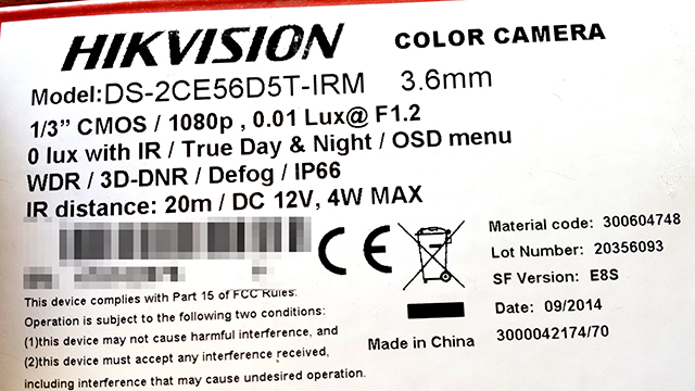

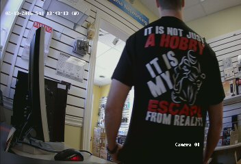

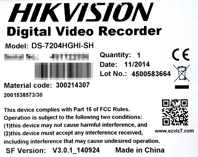

toysareforboys 0 Posted February 13, 2016 Do you think there would be any way to hack the firmware to change the resolution of the pictures it e-mails out when motion triggered? DVR model number set to record in 1080p: Camera model number: E-mails out these dinky resolution pictures: Let me know please and thanks! -Jamie M. Share this post Link to post Share on other sites
