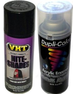

badmop 0 Posted July 5, 2015 You could always take a clear dome and on the inside (maybe outside?) spray it with that product that comes in a spray can for blacking out tail lights, amazon should have it, local automotive places. Smoking it yourself that way, and testing to see if the camera can see out alright. Just a thought Share this post Link to post Share on other sites
