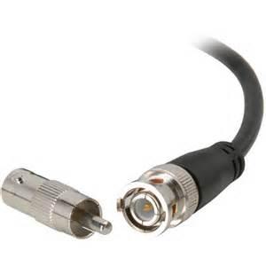

Numb-nuts 1 Posted July 6, 2015 Hi... I have a swann dvr8-3425 with hdmi and vga outputs. I have a rf modulator but I can't find the correct cable or device that I need to send the video from either the hdmi or vga from the dvr to the input of the rf modulator. I purchase a hdmi to rca cable on Amazon but nothing in being transmitted. Not sure if I have the right cable. Is there any easier method to transfer the video to all the tv in the house? Thanks No you should be using the Video Out port from the back of your DVR using a RG58 lead BNC to BNC and using 2 x BNC to RCA adaptors to connect to the modulator VGA and HDMI won't connect to your modulator. Share this post Link to post Share on other sites

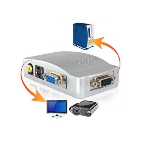

Securame 0 Posted July 6, 2015 You need a "VGA to video" adapter, which you will connect to the modulator. Something like this: http://www.securame.com/convertidor-video-rca-bnc-svideo-vga-tv501a-video-to-vga-p-850.htm You could also use a "HDMI to video" adapter, but it will be more expensive. Share this post Link to post Share on other sites
Numb-nuts 1 Posted July 7, 2015 Video out port is a legacy port from the older designs. Most of the HD and IP systems being produced now have no real use for a Video out RCA or BNC (composit) port "My DVR doesn't have...." Ah then you need a VGA to video adaptor convertor. A bit unusual these days I have a cabinet full that I bought in error. they should run you about £5- £10 and this will connect to your modulator. As was stated [i"]you could run a HDMI" convertor[/i] but as has already been said they "are more expensive" and I would add thereis no 'quality' benefit. Share this post Link to post Share on other sites
Chinaboy 0 Posted July 7, 2015 Thank you... I ordered vga converter and also an hdmi converter from amazon and should be here tomorrow. Will post back my results when tested tomorrow. Share this post Link to post Share on other sites
Chinaboy 0 Posted July 9, 2015 It's me again.... I got the VGA to video adaptor convertor and that seems to work with modulator, but I just cant seem to figure out getting the signal to the tv. I use a splitter to combine the video from the camera and cable signal for the cable company and then to the tv, but that seems to prevent some of my regular tv channels from working and I don't see any video from the cameras. I am using a smart tv connected to my cable box via HDMI and the coax cable from the cable company connected to the cable box. Should anything be connected to coax connection on the tv itself? Thanks Share this post Link to post Share on other sites
