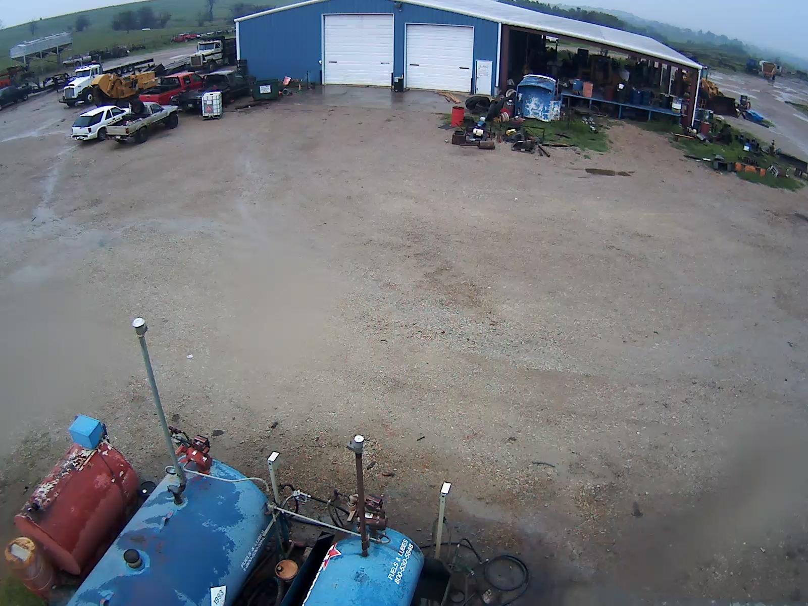

Sorry, I didn't install this myself, I saw it on a LinkedIn page: https://www.linkedin.com/company/3307745?trk=hp-feed-company-nam.
My guess that it's a outdoor Vivotek 2MP model like FD8363. Height is probably about 15-20 feet up. (full disclosure, I used to work for Vivotek)
