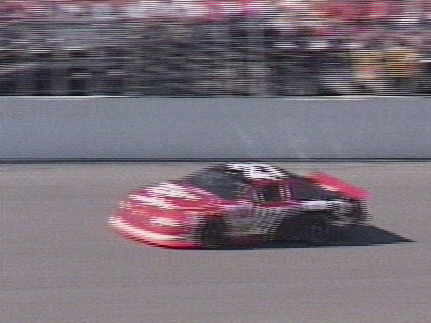

One word: interlaced.
Most analog cameras deliver interlaced video. That is where one frame (actually field) of video contains the odd scan lines and the other contains the even scan lines. When an object is in motion, the resulting picture looks like this:
IP cameras deliver progressive scan video. That means all scan lines are contained in each image.
Shutter speed and image resolution also have an effect on the ability to deliver images of the license plates of moving objects but interlacing is a major culprit.
