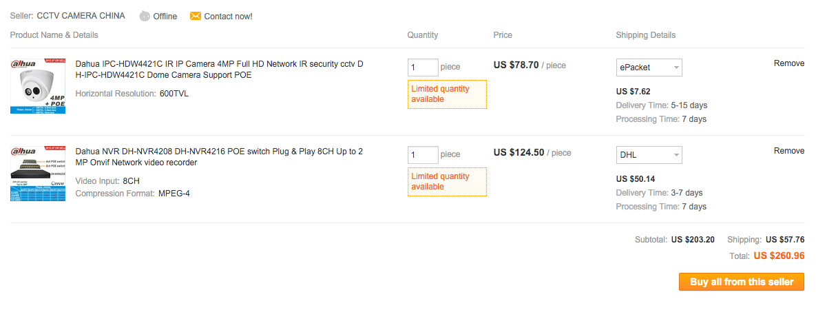

Boogieman 1 Posted July 16, 2015 The camera you selected does not have an sd card slot if you want that...Also, you have to understand what you are ordering.,..600tvl is NOT the image quality...they just use they to select the lens type..choose the 3.6mm lens for a standard install or the image will be too zoomed in... Share this post Link to post Share on other sites

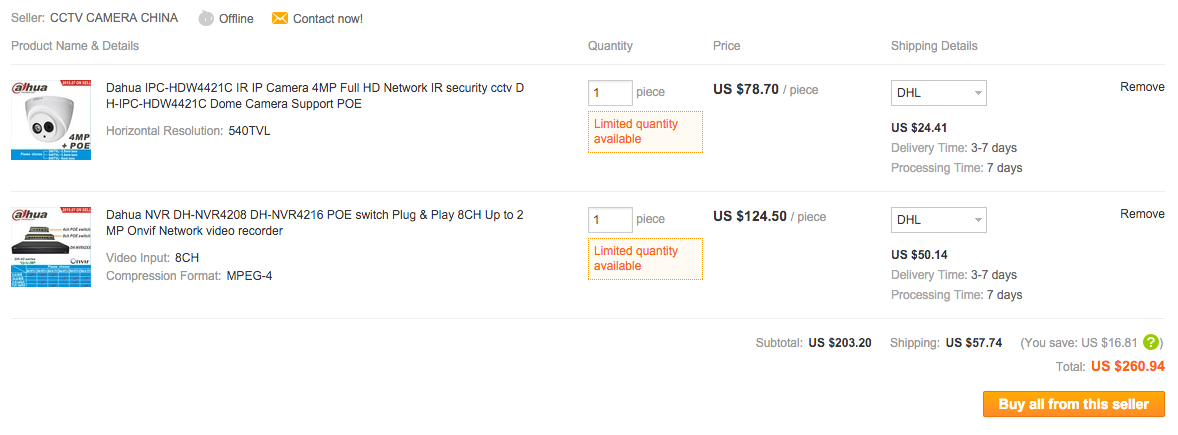

k2b13 0 Posted July 16, 2015 The camera you selected does not have an sd card slot if you want that...Also, you have to understand what you are ordering.,..600tvl is NOT the image quality...they just use they to select the lens type..choose the 3.6mm lens for a standard install or the image will be too zoomed in... Okay, I have selected the following: Now in regards to the SD card. I would prefer it to record onto a box, since the location of the camera will be quite hard to reach. I read a little bit, and I understand now: its a network box - allows me to view the video live through an ip or some portal. If that it is, that works very well for me. But some sort of recording is probably still needed. Share this post Link to post Share on other sites
Boogieman 1 Posted July 16, 2015 The camera you selected does not have an sd card slot if you want that...Also, you have to understand what you are ordering.,..600tvl is NOT the image quality...they just use they to select the lens type..choose the 3.6mm lens for a standard install or the image will be too zoomed in... Okay, I have selected the following: Now in regards to the SD card. I would prefer it to record onto a box, since the location of the camera will be quite hard to reach. I read a little bit, and I understand now: its a network box - allows me to view the video live through an ip or some portal. If that it is, that works very well for me. But some sort of recording is probably still needed. Yes that will work fine... Share this post Link to post Share on other sites
SunnyKim 2 Posted July 17, 2015 I do not agree to Boogieman's recommendation. Quite surprising as I know he advocates all the time HighTech, Expensive Systems including Mega Pixel IP Cameras, High End NVRs,etc, for all applications. Please make sure the points below. The camera shows 4MP that may mean HD Mega Pixel, but claiming 600 TVL as a Horiz resolution that may mean for old analog camera sensors. The NVR claims to support "MPEG-4" which is quite old compression standard, advanced by H.264. Please get Boogieman's confirmation whether the NVR can even support the camera before placing orders Share this post Link to post Share on other sites

SunnyKim 2 Posted July 17, 2015 I do not agree to Boogieman's recommendation. Quite surprising as I know he advocates all the time HighTech, Expensive Systems including Mega Pixel IP Cameras, High End NVRs,etc, for all applications. Please make sure the points below. The camera shows 4MP that may mean HD Mega Pixel, but claiming 600 TVL as a Horiz resolution that may mean for old analog camera sensors. The NVR claims to support "MPEG-4" which is quite old compression standard, advanced by H.264. Please get Boogieman's confirmation whether the NVR can even support the camera before placing orders Sunny I know from your posts that you know better than that. So PLEASE stop misinforming the poster. These are true HD cameras as you can clearly see from the spec. The nvr and the camera are NOT using mpeg4 but rather h.264. The reason why its the listing has the TVL and mpeg options is simply to let the user choose the type of lens, 2.8 3.6 etc and to allow choosing different options in the NVR like poe and the amount of channels. This is done because ali express does NOT have the option to let the vendor input the lens size. There are NO analog sensors on Dahua cams..the tvl numbers are added by the vendor in lieu of selecting the lens size. The vendor does the same think with hikvision cameras http://www.aliexpress.com/store/product/Original-hikvision-3megapixel-3mp-array-30m-IR-Network-Dome-DS-2CD2332-I-support-POE-free-shipping/638300_1396985171.html Do you understand now? You are deliberately misleading the op...these are the LATEST cameras from dahua. You know this and a purposely misinforming. Shame on you. Please stop recommending old analog junk to users. If 80 dollars for a camera is expensive then you are in the wrong line of work. Also please note that sunny works for a company that sells analog cards for pc...analog should not be used on a new install of this type. The only thing the op should confirm is that the NVR can support 4mp..its lists 5mp and 3mp...I am pretty confident that it will record the 4mp..worst case set the camera to 3mp.. Boogieman, I did not realize TVL number goes with recommended lens size. I am not quite familar to such terms in that field. It is quite shame that 4 Mega Pixel can be only represented as 600 TVL. But you seem to sell old IP cameras, as H.264 has been around 10 years. In our term, do not recommend a knife for a Bull to be for a knife for a chick. Every penny counts for all involved. Visit at ubiqmicro to see what I am doing for. Share this post Link to post Share on other sites
badmop 0 Posted July 17, 2015 If I may, to help clarify. (I could be wrong, but this is just my thoughts) Okay, TVL does mean quality with analog camears, BUT on aliexpress they have used TVL with a conversion chart to allow choices of LENS type with HD cameras. You know what I mean? Is that correct? Since aliexpress is limited in options when listing their products for sale, they just used TVL to list as an extra option for choice of LENS Size. That's what I gathered from looking at the cameras on aliexpress yesterday. Share this post Link to post Share on other sites
