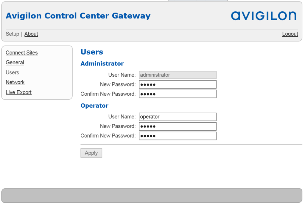

tomdlgns 0 Posted August 30, 2015 It helps to save the files to a folder instead of the desktop. It's also help to read help manual and watch YouTube training video http://4a54f0271b66873b1ef4-ddc094ae70b29d259d46aa8a44a90623.r7.cf2.rackcdn.com/assets/Uploads/en_US/PDFACCGateway06172015.pdf i got some answers to my questions from that PDF... - http authentication...when checked this disables the force of https/ssl. still not clear on the mobile/web users. this section explains the two built-in users but nothing about creating new users. By default, the Gateway has two users: an Administrator that configures the Gateway, and an Operator thatconnects to the Gateway through the ACC Mobile app or the Gateway Web Client. You can change the Operator username and password, but you can only change the password for the Administrator. The default Administrator username is administrator with no password. You are required to set a password immediately after your initial login. The default Operator username is operator with no password. It is recommended that you set a new username and password to increase the security The Users page, you can do any of the following: To change the Administrator or Operator password, enter and confirm a password in the New Password: field then click Apply. To change the Operator username, enter a new name in the User Name: field then click Apply. Share this post Link to post Share on other sites
ak357 0 Posted August 30, 2015 still not clear on the mobile/web users. this section explains the two built-in users but nothing about creating new users. By default, the Gateway has two users: an Administrator that configures the Gateway, and an Operator thatconnects to the Gateway through the ACC Mobile app or the Gateway Web Client. You can change the Operator username and password, but you can only change the password for the Administrator. The default Administrator username is administrator with no password. You are required to set a password immediately after your initial login. The default Operator username is operator with no password. It is recommended that you set a new username and password to increase the security The Users page, you can do any of the following: To change the Administrator or Operator password, enter and confirm a password in the New Password: field then click Apply. To change the Operator username, enter a new name in the User Name: field then click Apply. It's 2 step login process First log in is to access mobile App second to access server meaning YOU create new users on Server Get it ? Share this post Link to post Share on other sites
tomdlgns 0 Posted August 30, 2015 still not clear on the mobile/web users. this section explains the two built-in users but nothing about creating new users. By default, the Gateway has two users: an Administrator that configures the Gateway, and an Operator thatconnects to the Gateway through the ACC Mobile app or the Gateway Web Client. You can change the Operator username and password, but you can only change the password for the Administrator. The default Administrator username is administrator with no password. You are required to set a password immediately after your initial login. The default Operator username is operator with no password. It is recommended that you set a new username and password to increase the security The Users page, you can do any of the following: To change the Administrator or Operator password, enter and confirm a password in the New Password: field then click Apply. To change the Operator username, enter a new name in the User Name: field then click Apply. It's 2 step login process First log in is to access mobile App second to access server meaning YOU create new users on Server Get it ? i created the user on the server, but that user can't login to the mobile app. i don't have any issues logging into the mobile app with the administrator account, for obvious reasons. also, i can't seem to restrict a user to specific camera(s), they are all checked and grayed out when i am editing the permissions/settings. Share this post Link to post Share on other sites

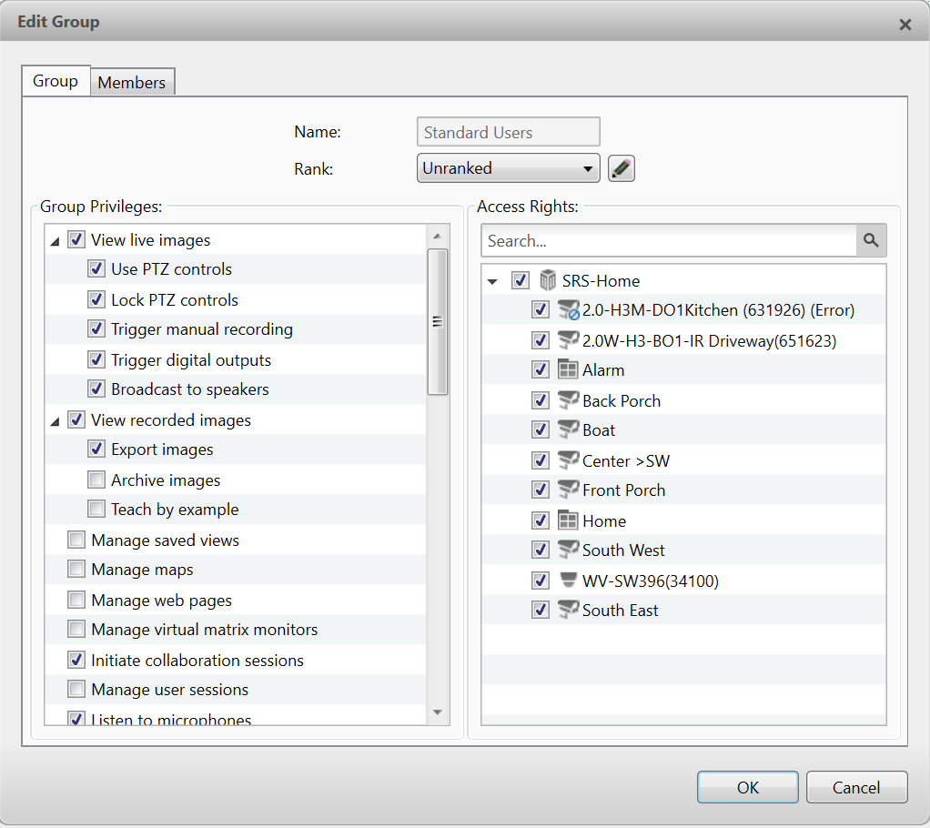

ssmith10pn 0 Posted August 30, 2015 There are only 2 gateway accounts. User access to cameras are set in group policies not users. Share this post Link to post Share on other sites
tomdlgns 0 Posted August 30, 2015 There are only 2 gateway accounts. [im g]http://www.cctvforum.com/images/imported/2015/08/276743_1.png[/img] User access to cameras are set in group policies not users. [im g]http://www.cctvforum.com/images/imported/2015/08/276743_2.png[/img] yeah, i was able to find the two gateway accounts, those were visible when i first accessed the gatewat (after install). thanks for pointing out the group tab, didn't even think to click on it...makes sense now. Share this post Link to post Share on other sites
