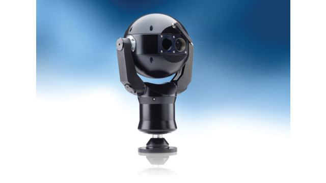

One of these fitted to roof of your car will work .... Bosh metal mic and a joy stick for you to control
You will have 360 view and will see 1/2 a mile for you.

How much are we talking for one of those cameras? I see that it rotates and that sounds like a great idea, but am I seeing only one direction as it turns? It only has one camera on it so I would need to rotate it left and then right to see if it's clear...but by the time I see right, something might come from the left.
How much are these cameras? I'm thinking I need to be able to see left and right at the same time so I can definitely make the right call when it's clear. Wouldn't it be best to just have stand-still cameras? I really don't need to see 360 degrees, although it might come in handy when backing up, but I've avoided backing up for the most part. My major concern is seeing left and right at stop signs because I honestly don't leave town that much.
