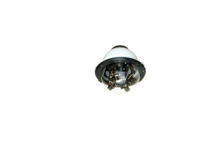

rapid 0 Posted March 22, 2006 Have a look at this Videolarm QFID housing. Planning on using this for a parking lot application looking different directions. Their housing can accommodate up to 4 board cameras. You choose the lens/canera combination. Dome housing is 12 inches with an 8 inch dome. Housing is all factory wired. Maybe this will meet your needs. Cheers......Rapid Share this post Link to post Share on other sites

lvguy 0 Posted March 22, 2006 I looked at that camera ball, but it was too much $$ for something that utilizes 4 board cameras. So I'm trying to do better and stay within a budget by making my own. I'm using their 18" dome and I just found some small cs mount cam bodies. So it should be better, but I'm not going to try and get a 360 view. I've decided to add some domes to cover the rest of the space. Share this post Link to post Share on other sites
